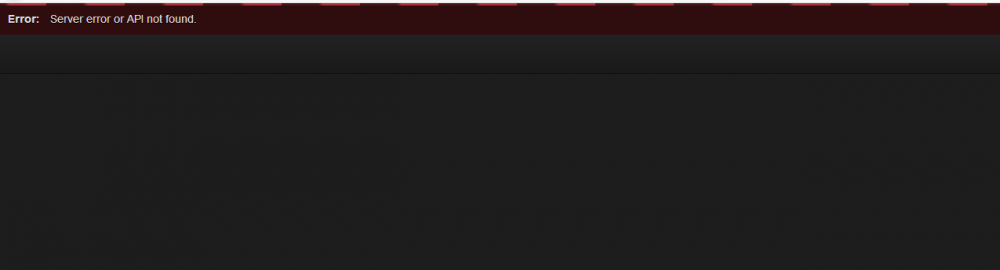

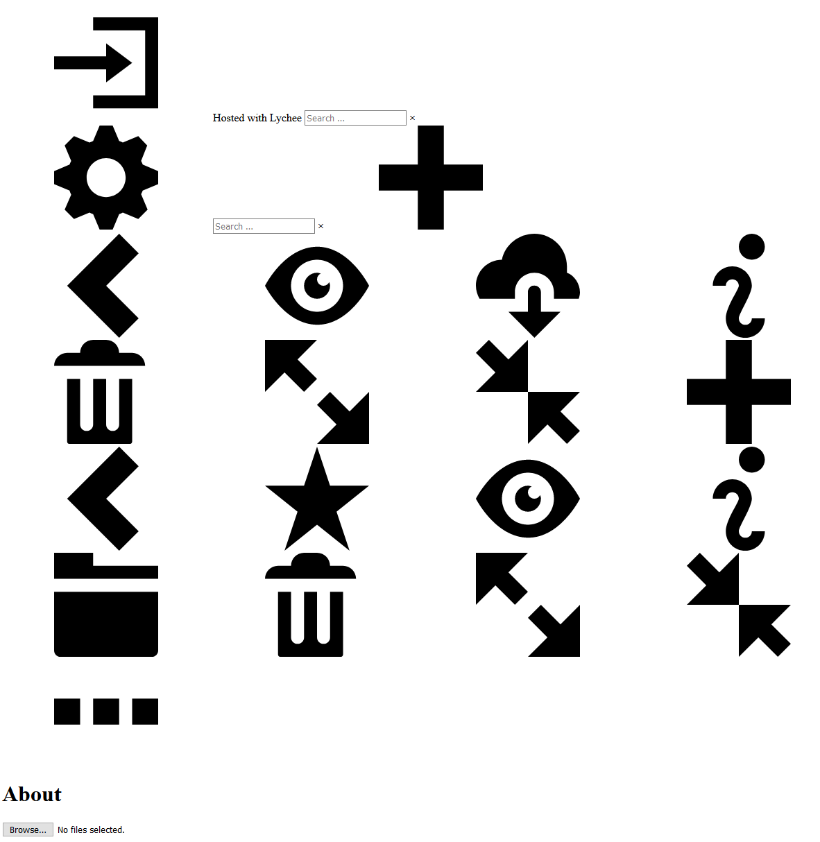

This first method results in the formatting looking all wrong. I'm guessing the CSS is not making it through. See Capture.PNG.
The second method:
#Lychee proxy attempt #2
location /lychee {
   proxy_pass http://192.168.178.25:8082/;
   proxy_set_header X-Lychee-Base "/lychee/";
   add_header X-Frame-Options SAMEORIGIN;
This method results in what looks like the right format but no site. See Capture2.PNG.
Any ideas on this please?

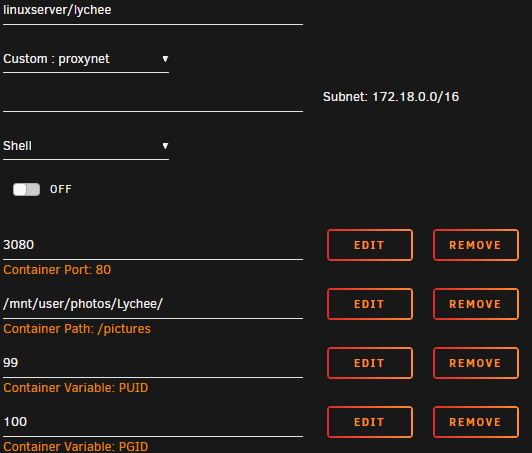

I'm trying to make my Lychee website open to the public via LetsEncrypt and reverse proxy.
I've got the Lychee docker container using port 3080.
I've modified the existing lychee.subdomain.conf file to include a port number.
server {
    listen 443 ssl;
    listen [::]:443 ssl;
    server_name lychee.*;
    include /config/nginx/ssl.conf;
    client_max_body_size 0;
    # enable for ldap auth, fill in ldap details in ldap.conf
    #include /config/nginx/ldap.conf;
    location / {
        # enable the next two lines for http auth
        #auth_basic "Restricted";
        #auth_basic_user_file /config/nginx/.htpasswd;
        # enable the next two lines for ldap auth
        #auth_request /auth;
        #error_page 401 =200 /login;
        include /config/nginx/proxy.conf;
        resolver 127.0.0.11 valid=30s;
        set $upstream_lychee lychee;
        proxy_pass http://$upstream_lychee:3080;
But when I try to access the page, all I get is a 502 error.
Does anyone know what is going on?
I don't think you need that port number. I don't have it and mine is working.
        proxy_pass http://$upstream_lychee;
That did the trick. Removing the port number in lychee.subdomain.conf fixed it. ☺

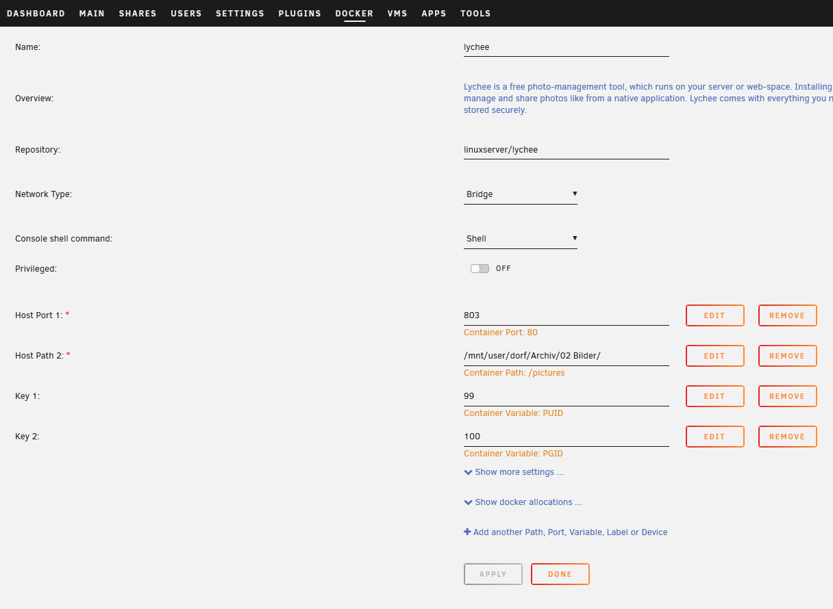

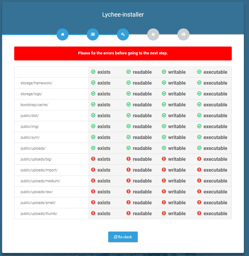

Hey i got problems with permissions with lychee installer.
i stuck on part 3 and i dont know where the folders are.

I also had this problem. I simply uninstall lychee and delete the installation folder to make a new one.

    Diagnostics
    Info: Latest version of PHP is 7.4
    Error: '/app/lychee/public/uploads/big' is missing or has insufficient read/write privileges
    Error: '/app/lychee/public/uploads/medium' is missing or has insufficient read/write privileges
    Error: '/app/lychee/public/uploads/small' is missing or has insufficient read/write privileges
    Error: '/app/lychee/public/uploads/thumb' is missing or has insufficient read/write privileges
    Error: '/app/lychee/public/uploads/import' is missing or has insufficient read/write privileges
    Warning: You may experience problems when uploading a photo of large size. Take a look in the FAQ for details.
    Warning: Dropbox import not working. dropbox_key is empty.
    System Information
    Lychee Version (release):        4.0.8
    DB Version:                      4.0.8
    composer install:                --no-dev
    APP_ENV:                         production
    APP_DEBUG:                       false
    System:                          Linux
    PHP Version:                     7.3
    Max uploaded file size:          20M
    Max post size:                   200M
    MySQL Version:                   10.4.17-MariaDB-1:10.4.17+maria~bionic-log
    Imagick:                         1
    Imagick Active:                  1
    Imagick Version:                 1802
    GD Version:                      bundled (2.1.0 compatible)
I spent a few hours but I'm pretty stuck.  Any suggestions?  Thanks in advance
Did u get it work? I attached to the docker console and created the missing directories with proper owner and permissions. I feel that that is not the right way. I also exposed the path /app/lychee/public/uploads/import/ and put some files in it . This way I got the import running. It ran for a while, then stopped and didn't load any pages anymore (some API error). Now it won't start anymore.
