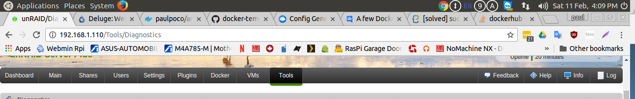

The only problem is my App tab has disappeared.
I did just have a non-responsive VM and web gui and ssh not connectable, had to do a hard powerdown as the press the powerbutton once didn't shut it down gracefully as I would of seen the HD light go crazy.
58aad859bbf37_Screenshot_at_2017-02-11_160907.png.6fe19cbbc0e59df12fce23bc0ce5816a.png
unraid-diagnostics-20170211-1608.zip

The Apps tab comes from Community Applications plugin, which you don't seem to have installed.

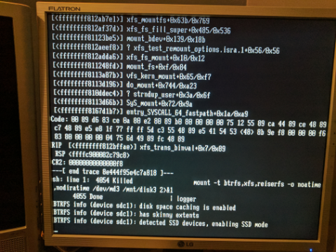

See if you can get the diagnostics on the console after trying to start the array with current parity disk.
How do I get diags from console?  How would I save that?
I took a picture of what showed on the console screen right after starting array.

Swapping out the parity won't do anything.  You have file system corruption on disk 3, and need to check the filesystem
Like I said before you need to start in maintenance mode and run xfs_repair on disk3 (dev/md3)

ALERT: The filesystem has valuable metadata changes in a log which is being
destroyed because the -L option was used.
        - scan filesystem freespace and inode maps...
Metadata corruption detected at xfs_agf block 0x1/0x200
flfirst 118 in agf 0 too large (max = 118)
sb_fdblocks 201379159, counted 201386137
        - found root inode chunk
Phase 3 - for each AG...
        - scan and clear agi unlinked lists...
        - process known inodes and perform inode discovery...
        - agno = 0
        - agno = 1
        - agno = 2
        - agno = 3
        - process newly discovered inodes...
Phase 4 - check for duplicate blocks...
        - setting up duplicate extent list...
        - check for inodes claiming duplicate blocks...
        - agno = 3
        - agno = 1
        - agno = 2
        - agno = 0
Phase 5 - rebuild AG headers and trees...
        - agno = 0
        - agno = 1
        - agno = 2
        - agno = 3
        - reset superblock...
Phase 6 - check inode connectivity...
        - resetting contents of realtime bitmap and summary inodes
        - traversing filesystem ...
        - agno = 0
        - agno = 1
        - agno = 2
        - agno = 3
        - traversal finished ...
        - moving disconnected inodes to lost+found ...
Phase 7 - verify and correct link counts...
Maximum metadata LSN (4:369441) is ahead of log (1:2).
Format log to cycle 7.
        XFS_REPAIR Summary    Sun Feb 12 13:33:19 2017
Phase Start End Duration
Phase 1: 02/12 13:26:51 02/12 13:26:51
Phase 2: 02/12 13:26:51 02/12 13:28:00 1 minute, 9 seconds
Phase 3: 02/12 13:28:00 02/12 13:30:39 2 minutes, 39 seconds
Phase 4: 02/12 13:30:39 02/12 13:30:39
Phase 5: 02/12 13:30:39 02/12 13:30:39
Phase 6: 02/12 13:30:39 02/12 13:30:41 2 seconds
Phase 7: 02/12 13:30:41 02/12 13:30:41
Total run time: 3 minutes, 50 seconds
done
So the Disk 3 is one I do not trust 100%.
I know I screwed up my Parity.  (I tried the xfs_repair thing on sdd, and then tried formatting, yes my super bad)
So if I can get the array up, I already bought a new WD RED 6TB drive, and if the data seems fine(don't really have a choice now), can i shut down properly, swap out the 6TB for the 5TB, Turn back on run Parity on new 6TB drive?  10-12 hours later take out disk 3 which is 3TB and replace it with the 5TB one?
Yes
Ok I am back up and running on 6.3.1, thanks for everyones help, sorry to be such a noob
