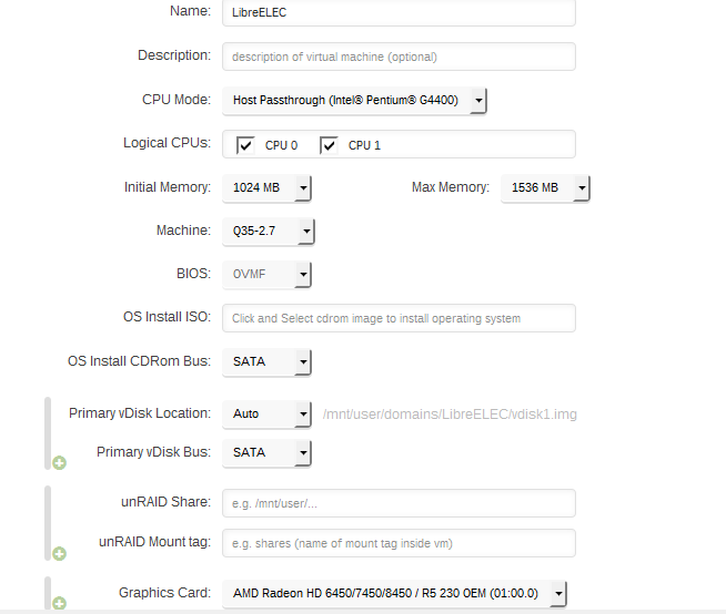

Hi Stripe, any chance you could post a screen shot of the VM's setup page?
I still have not been able to succesfully do this.
Thanks!
H.
I tried yesterday too and it works with AMD HD6450.
When you create VM you must add a vDisk and point the first one to location where you store libreelec img file and second to the default location of your VM. After installation is complete you can delete the first vdisk. If you have any problems with booting, check the boot priority of vdisk in your xml file. Do not use "Os install ISO".
Edited by Stripe
15 hours ago, Squid said:
Been forever since I did it, but you can probably just select Linux and follow the thread.
Full blown VM might not work then, as IIRC it requires a passed through video card whereas LT's templates work with noVNC
The template VM works perfect without a GPU pass through. It's been running stable for a long time for me.
I'm using the LibreELEC template.
What I want to know is, who created it, and how did they manage to get it working with VNC.
Edited by exist2resist
