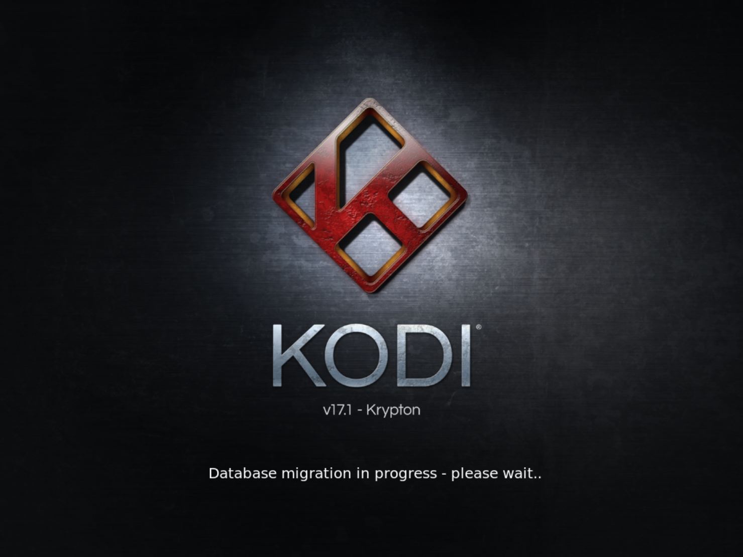

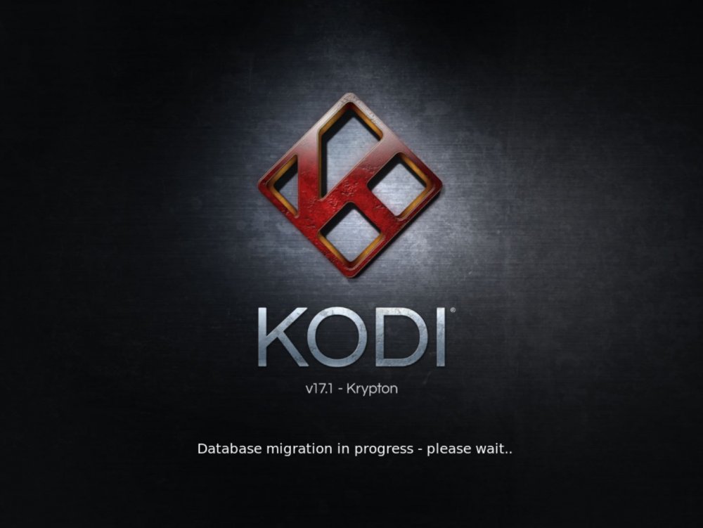

Template works thanks for that.
All I had to change in my XML were the <channel> and <video> sections.
What a beautiful sight.
Edited by exist2resist
Also if you change the VM resolution to 640x480p it becomes way more responsive.
