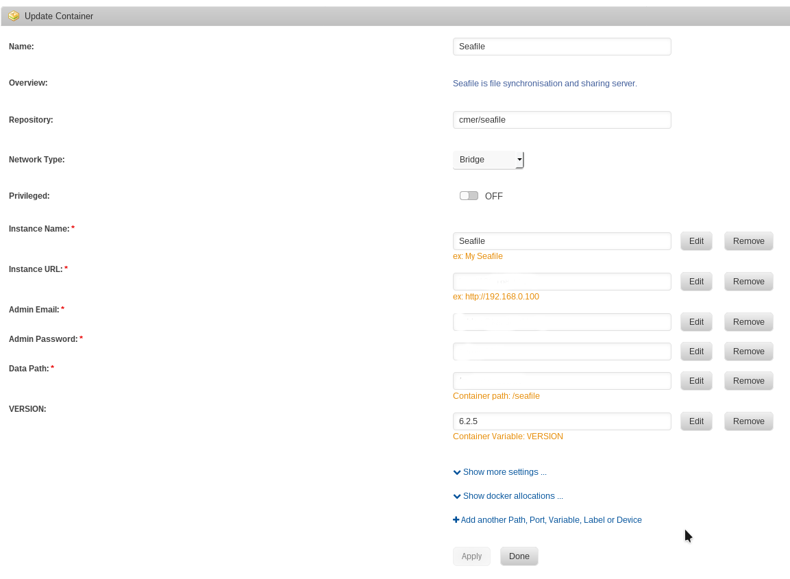

I just started having an issue. It looks like I upgraded from 6.2.5 to 6.3.0 and now seahub won't start and the container shuts down. Here is the log:
[05/27/18 15:42:55] ../common/session.c(132): using config file /opt/haiwen/conf/ccnet.conf
Starting seafile server, please wait ...
Seafile server started
Done.
Starting seahub at port 8000 ...
Error: '/opt/haiwen/conf/gunicorn.conf' doesn't exist
[33mError:Seahub failed to start.[m
Please try to run "./seahub.sh start" again
I haven't changed any configs or anything, it just stopped working. Any way I can get this going again?
Done.
Please add a custom environment variable 'VERSION' and specify desired version.
