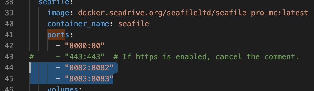

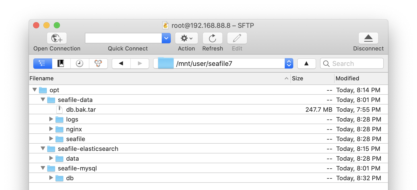

Some notes on my upgrade experience:
- Upgrade instructions 6.3 to 7.0 https://download.seafile.com/published/seafile-manual/docker/6.3 upgrade to 7.0.md
- For deploying Seafile-pro https://download.seafile.com/published/seafile-manual/docker/pro-edition/6.3 upgrade to 7.0.md
- Make sure to edit the yml as needed.
- File structure: I organized the application files in a dir at "/mnt/user/seafile7/opt", that way it is in harmony with the Seafile documentation.  Hopefully this makes it easier to troubleshoot/maintain in the future.
I hope this helps
edit - seems I also had to expose ports for "seafhttp" "seafdav".  Not sure if I had set this up myself in my previous installation or the docs forgot to mention it
866715257_ScreenShot2020-02-17at10_34_35PM.thumb.png.3621c67045b551fcdca0f42f936925e7.png
Edited by m8ty
added a screenshot of the folder structure I use
