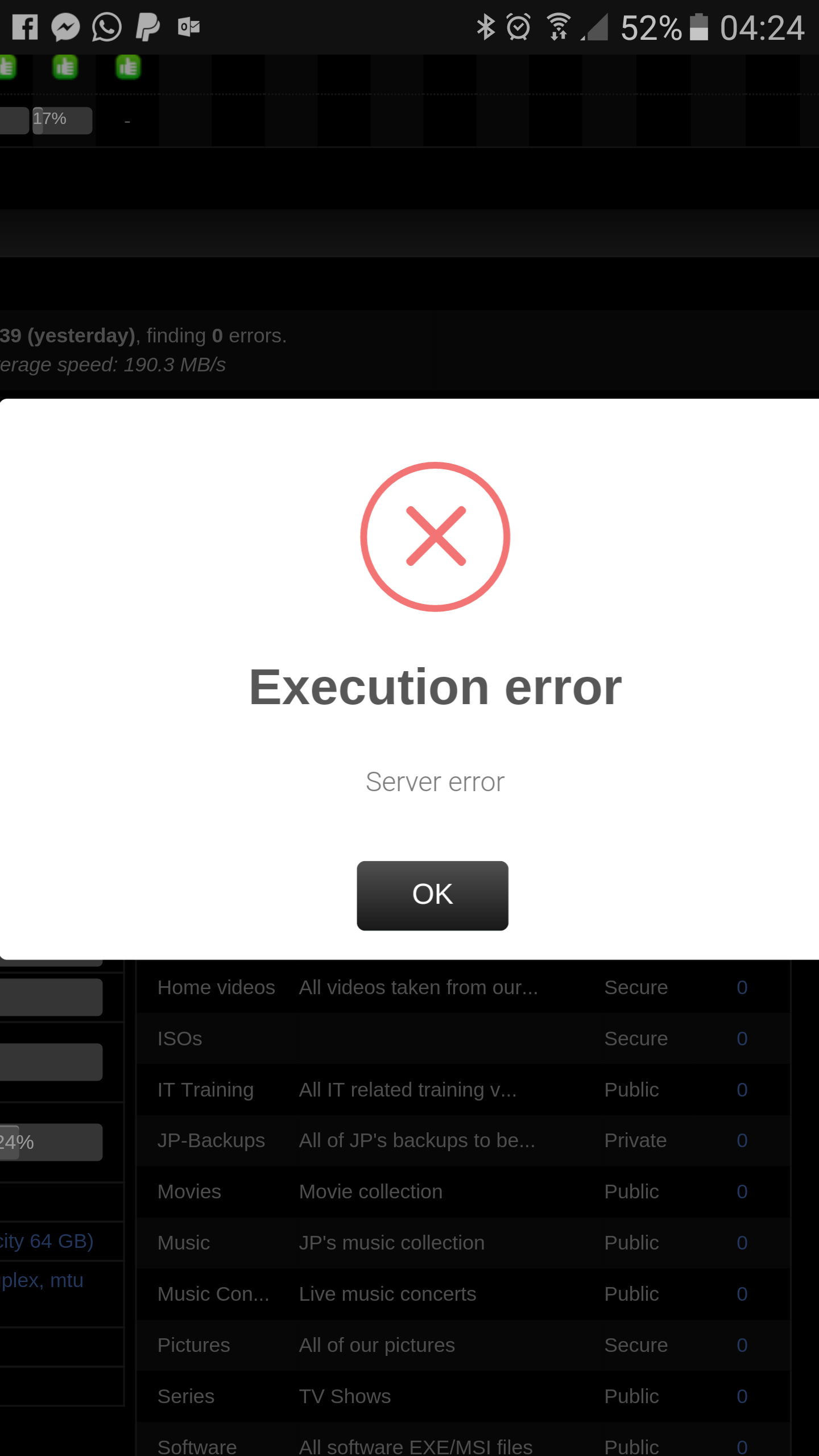

1st time became unresponsive the GUI will not respond just frozen. Telnet was OK. SMB shares go offline. all apps stop. system log goes crazy. Had to hard power down and then parity check to continue
2nd time exactly the same but WEB GUI was responding but when ever i attempt to start a docker i get "Execution error server error" so it is running but i cannot start any dockers.

I run 2 HP 146 10K SAS drives in my cache pool and with the "BTRFS: error (Device loop0)" errors i am getting on the server monitor is there an issue with my cache pool? is transcoding causing issues with these drives? should i move appdata and system onto the array as they are set to "preferred" at the moment(only things on the cache is appdata and system)
Log file why does it spam "tower kernal: mptbase: ioc0: warning - issuing reset from mpt_config!!, doorbell-0x2400000" I have no idea what this means? see screenshot my entire log is full of this after the crash.
This means there are problems with the docker image, you should delete and re-create.

Did a lot of digging and it would appear my "tower kernal: mptbase: ioc0: warning - issuing reset from mpt_config!!, doorbell-0x2400000" is pointing to my SAS drive or SAS controller as my motherboard has 2 chip sets on it with 14 SATA slots so i am going to remove the SAS drives and run nothing on the SAS controller and see what happens. Currently the SAS drives run my cache so i will do the mover to get all my stuff off the cash and go from there. I will report back tonight
