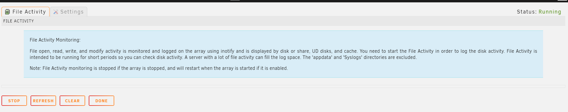

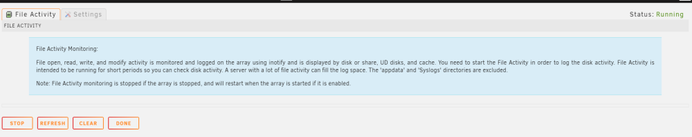

Iam doing something wrong?
Post thediagnostics zip file.
Its working. Sorry - it just got a while to display used files.

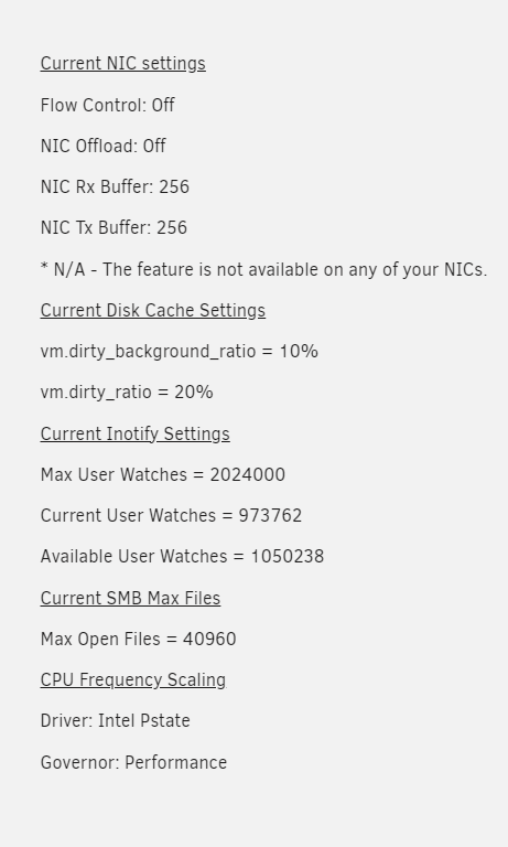

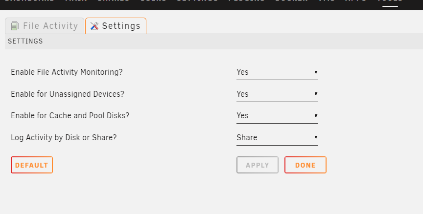

Hi I'm unable to get file activity to start.
Syslogs look like this.
Mar 12 00:38:50 NewNas file.activity: Starting File Activity
Mar 12 00:38:50 NewNas file.activity: File Activity inotify starting
Mar 12 00:38:50 NewNas file.activity: File Activity inotify exiting
It never starts and just goes back to a stopped state when I attempt to start it.
I have a very high iNotify watch number but still no joy?
Any idea
Any idea
Post diagnostics.
6 hours ago, dlandon said:
Show a screen shot of your File Activiy setup.  Also show a screen shot of the Tips and Tweaks plugin showing the inotify watches.
Edited by zoro25
Some suggestions:
  • Turn off monitoring of Unassigned Devices.
  • Turn off monitoring of Cache and Pool devices.
The 'appdata' folder on a cache or pool device can have a large amount of files to monitor and normally a cache or pool device is an SSD.
17 hours ago, dlandon said:
Some suggestions:
It's running now thanks.
Thanks for your help.

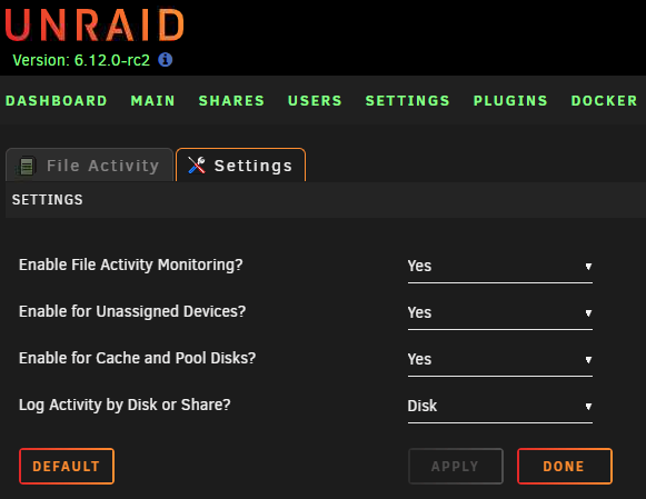

On 2/6/2023 at 7:45 PM, dlandon said:
The file activity plugin was designed to help with array spin ups.
Question: does FA show me write operations of zfs Pools consistin of multiple harddisks (not SSD) in Raid0 mode in unraid 6.12.0 rc2?
I have FA installed.
I habe a pool/cache of 2 Harddrives, that I access only one every day or less. But everytime I look in the unraid main tab those disks seen to be spinning (green indicator).
In Syslog: i can not see what is waking them up.
In FA: Actvity is empty, even when I just wrote several files to the share, that is exclusively on that zfs pool.
(FA config, see screenshot below).
FA-POOL-zfs-2023-04-01 22_44_34-102 Tessa Main (TESSA-MAIN1064) – VNC Viewer.png
Post diagnostics.  Also look at the output of this command:
cat /tmp/file.activity/file.activity.disks
and see if the share in queston is in that output.
