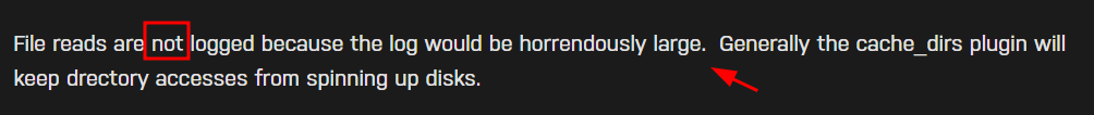

Here is some information on how File Activity works.  These are the file events that ae set up with inotify to watch:
open,attrib,move,create,delete,modify
File reads are not logged because the log would be horrendously large.  Generally the cache_dirs plugin will keep drectory accesses from spinning up disks.
There are some automatically ignored shares because watching those shares would also generate a large amount of logging:
appdata, syslogs, and system
File activity in these shares will be ignored.
