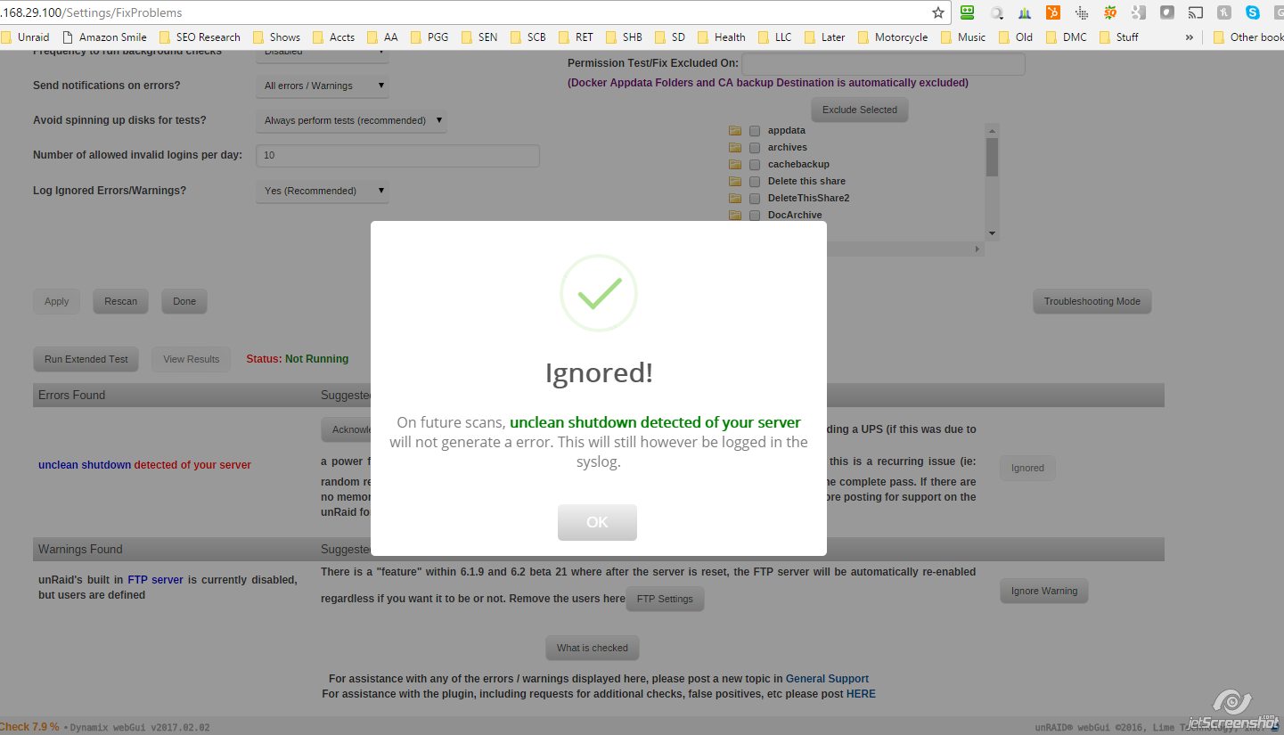

I had to do an unclean shutdown of my server (became unresponsive after 6.3.1 update).  Simple power off/on... (not good I know, but had to...).  So I got a warning in Fix Common problems.  Since I knew the source I clicked "Ignore".  What I didn't see was the "Acknowledge Error" in the upper right...  :o  So my initial reaction wasn't correct...because I didn't see the Acknowledge button...
Because I clicked the IGNORE button, this message was presented - basically saying that it will ignore ALL FUTURE UNCLEAN SHUTDOWNS?!?  Not what I wanted.  Its what I did, but not what I wanted.  How do I turn this monitor back on?

Agree on the lack of ability to get it back.  Delete on the flash drive the ignorelist (config/plugins/fix.common.problems/ignore

Looks like your message got truncated.  Looks like you mean config/plugins/fix.common.problems/ignoreList.json?
Not truncated but couldn't remember the exact name of the file and figured you would be able to get the general gist

That worked, thanks!

As of a day or two ago, FCP will allow you to selectively re-monitor any items regardless of if they are in the current found list or not...
