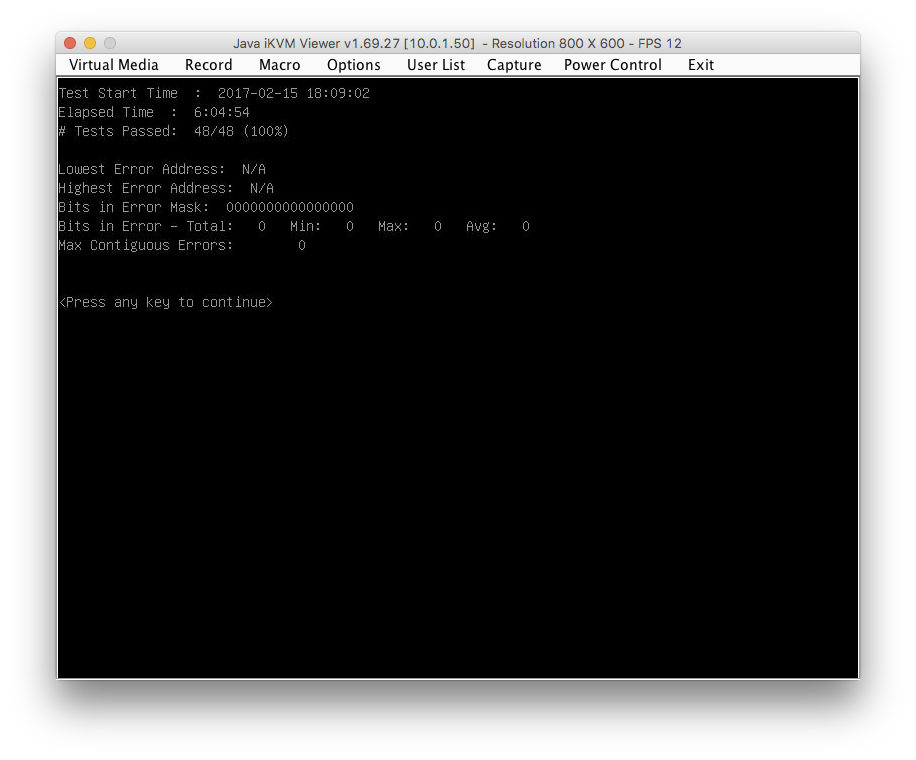

So i just went to check in on MemTest, and it said something like "all tests passed, press any key to continue".
I'm attaching the screenshot of the next page which showed the summary.
I was assuming that this would just continue to run until I stopped it.. do i need to configure it somewhere to keep running, or should I just continue to restart the test every ~6hours?
