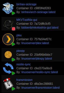

Enclosed is a picture of the dockers installed, since I suspect one of them is causing the issue.

You can't modify what exactly?  A file downloaded and then moved?  Usually you can look for an option to set the permissions on files within the clients.  Set it to 777.  Or it just be issues with the file system on the cache drive.  Hard to tell without diagnostics for that one.
