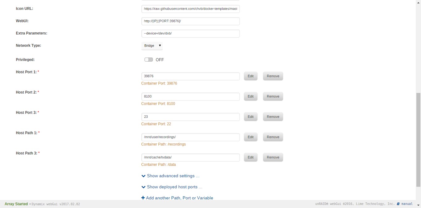

I'm trying to setup the dvblink docker http://lime-technology.com/forum/index.php?topic=49578.0 but it looks like it's not downloading any files during setup and all my directories are empty.
Would somebody else mind having a go just to see if they can get it to install please.
I can't work out if it's me or if the docker is broken.
could someone try and install the docker please - don't need a tv card, I just want to see if it should be running.
Thanks
ok, someone who understands unRAID much better than me has tried installing this docker and it doesn't install.  Can anyone see quickly in the code why it's failing?  It doesn't look like a lot of commands so hopefully something will jump out straight away.
I've tested the http://download.dvblogic.com/9283649d35acc98ccf4d0c2287cdee62/ link in the docker and it downloads a file, so I'm at a loss why the docker installation installs no files at all.
Thanks in advance for any help
