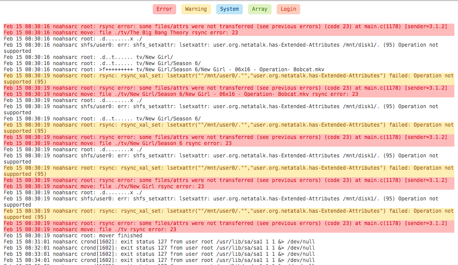

I recently upgraded to 6.3.1 and ever since, the mover does not work on my media files.  I should also say that after I updated, my cache pool was shown as 'unmountable' but I was able to get it back by running a btrfs check.  When it came back, my cache still had all the docker file structure in place but the dockers needed to be reinstalled.  I used my existing templates so from what I can tell the configuration for them has not changed.  I then ran a Scrub and Balance on my cache pool and all seemed to be working except for the Mover.
The files aren't moving from the Cache to the Array and the log is showing some kind of errors with extended attributes but I can't track down the cause.  I have included a snap shot of the error and the diagnostics from my server.

It seems that ReiserFS's handling of extended attributes has been broken. I use AFP but all my hard disks are XFS-formatted. I have a tip for AFP users, here.

Extended attributes are not the same as Apple resource forks. The dot-underscore sidecar files are a means of storing resource fork information on basic file systems. If you created your boot flash on a Mac you probably have them there too on its FAT file system. So I don't really see how deleting them is going to make any difference anyway, since they are merely ordinary files with slightly odd names and normally hidden content.
Your problem, as I understand it, is not that macOS is creating .DS_Store files and ._* files but that files with extended attributes are being created on your cache which the mover is then unable to move to the array because ReiserFS is broken. I think it's the fact that you are using macOS with SMB with ReiserFS that is causing your problem. You might find that using AFP will work better than SMB until such time as you are able to convert to XFS.
