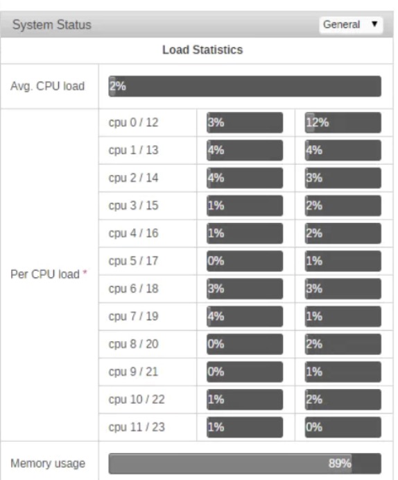

So in my attached image, the first row is 0/12. Does that mean that 0 is a real core and 12 it its HT counterpart? If so, I'm guessing the correct load if VM1 was running cinebench would be the top 6 rows are all at 100%. Mine's currently not set up like that. Mine is setup so when VM1 in benchmarking, the left column is at 100%.

Ok. This ideal then?:
VM1 cores 1,13,2,14,3,15,4,16,5,17
VM2 cores 7,19,8,20,9,21,10,22,11,23

Based off of your findings, and the pic of my available CPUs above, does the above configuration I've put follow your most successful tests?

No. Your pinning follows common accepted practice for windows vm's which in terms of total power/performance is limited by the fact that both threads on the cpu can not run 100%. My testing showed that virtualized windows does not know/care if a given core/thread you've assigned it is on a single core or sharing with another.
With that said, some people find that they improve latency issues in win10 by putting a vm on its "HT pairs." I haven't posted anything in regards to this, but I also did testing a short while ago for this issue, and found essentially no gain doing it that way.
For me, the way I run my vm's is as follows: I stack 2 vm's on a given core's paired thread (so, for you that would be vm 1: 1-11, vm 2 13-23.) Why? Because neither of them typically run 100% at the same time.
A physical core can run about 180% total utilization with both threads maxed (these numbers are not exact and vary processor to processor but we'll go with them for now as general estimates based on testing.) If both threads are attempting to using 100%, they each get bottlenecked by the other and capped about 90%. If you have a vm using all single threads ( for instance 1-11) then it has access to 100% of the thread potential if the other vm running on the paired thread is attempting to use 80%ish or less utilization. If you put them on their own HT paired core, then if they are attempting to use 100% utilization on each thread, it will never achieve it. This is essentially what was shown in my testing.
So again, I reiterate, this is all about pure power and has nothing to do with latency that some people get. But I also am beginning to think that many people's problem with audio/video latency and other cpu pinning issues comes from using single processors that either don't have the power or mobo support to backup running multiple vm's, or even getting a single one to play nice. I have a hard time getting my system to behave "badly" in term of vm performance. But I'm also on older enterprise equipment that was made for virtualization.
As I tell everyone, my results may be because of my hardware and that they should experiment for themselves to see what works best for them. All I really know is how to get almost every ounce out of my own machines, and the benchmarks/testing that backs up why I do what I do.
