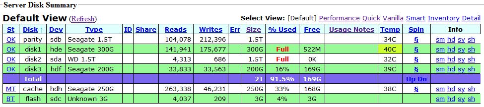

now, since the one drive failed, im a bit short on space, only 160gb free there and 2 of my drives are full, only the last drive i added has space on it, along with the cache drive until i get the RMA from WD

HD: see screenshot
