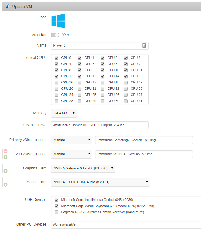

Hi folks,
I'm having doubts about my dual xeon configuration when assigning cores to each VM. In the screenshot attached, have I assigned "CPU 1" to one VM, or have I mistakenly assigned alternating cores from both Xeons? Ignore the label "Player 2", I've been tinkering with cores.

I would not assign cores 0,1 as unRAID likes to use those for itself, otherwise I am not sure if your core pairing is correct.
No. That doesn't look right at all.
Have a look at the Dashboard page of the WebUI since it displays cores paired. Typically it would be Core 0 paired with Core 16, and Core 1 with Core 17 ... and Core 15 with Core 31. That's how my Dual Xeons are paired.

That's how I have mine setup, my single core/two thread VMs run just fine this way... at least as long as I have the correct core/threads assigned as the PCIe lane as the GPU.
