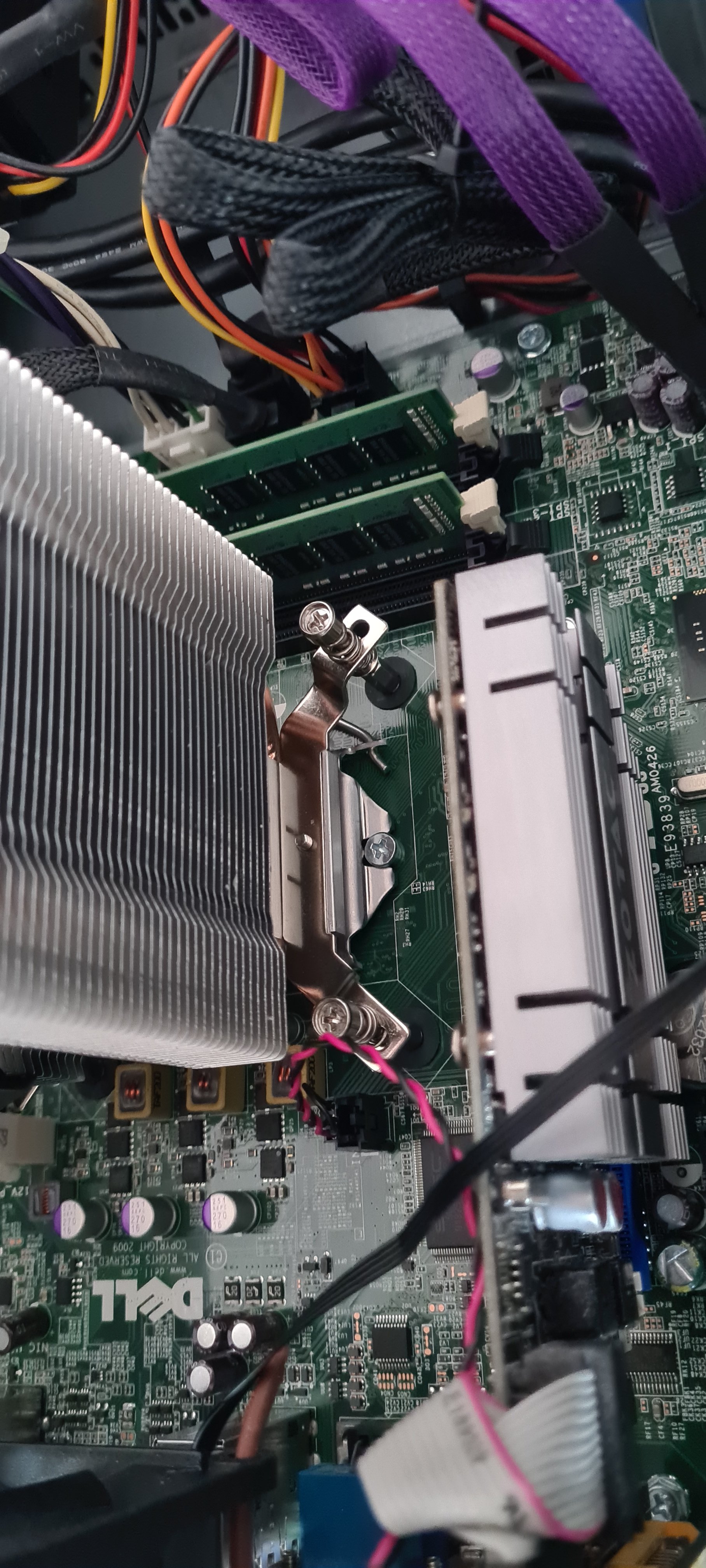

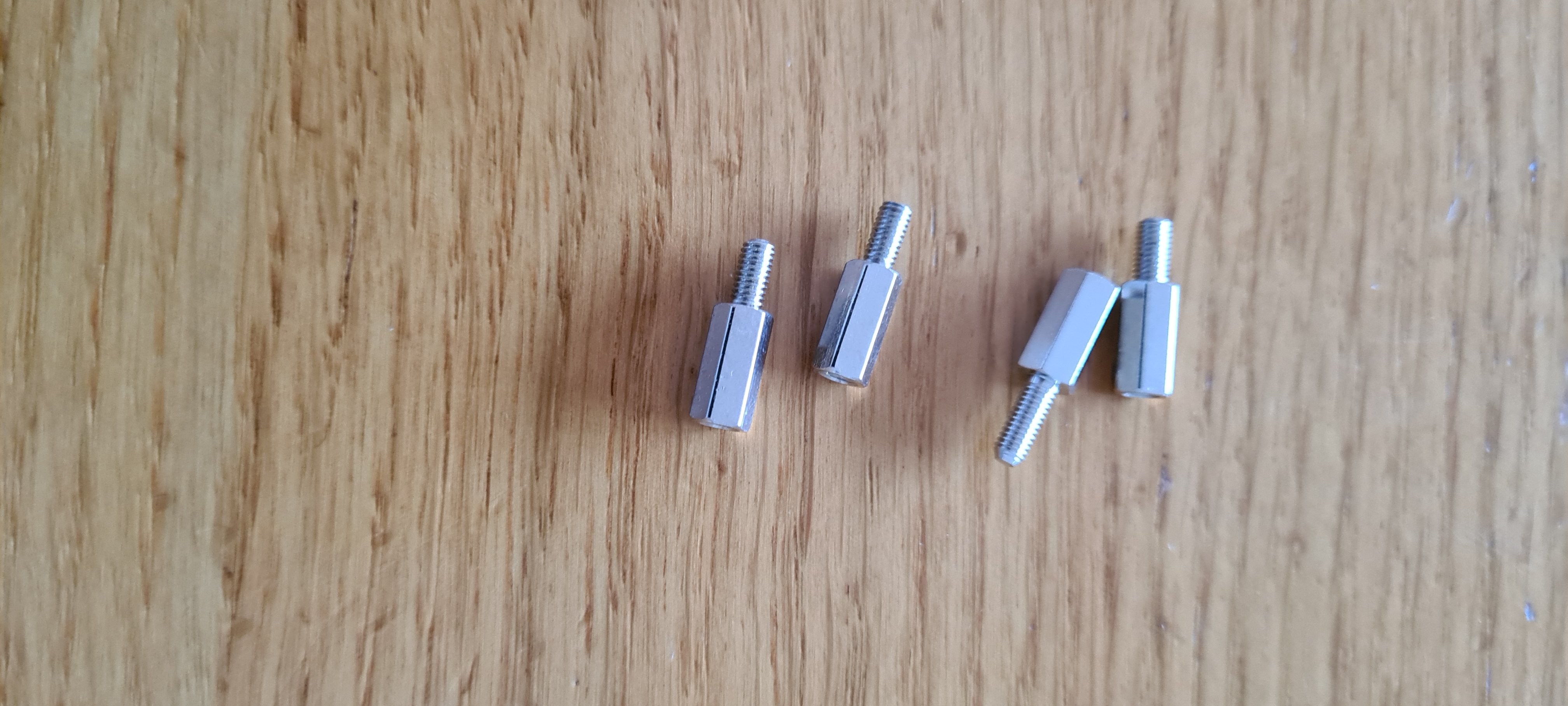

I had bought a Noctua CPU cooler to get better and quieter cooling.... BUT dell's motherboards have a rear plate over the CPU spot where any standard CPU cooler that requires a custom bracket back there just won't work.  I have yet to research finding one that would.
hi,
did you find any working solution? I'm struggling with same issue...
  • 7 months later...
The solution is in small M3 1 cm spacers.
