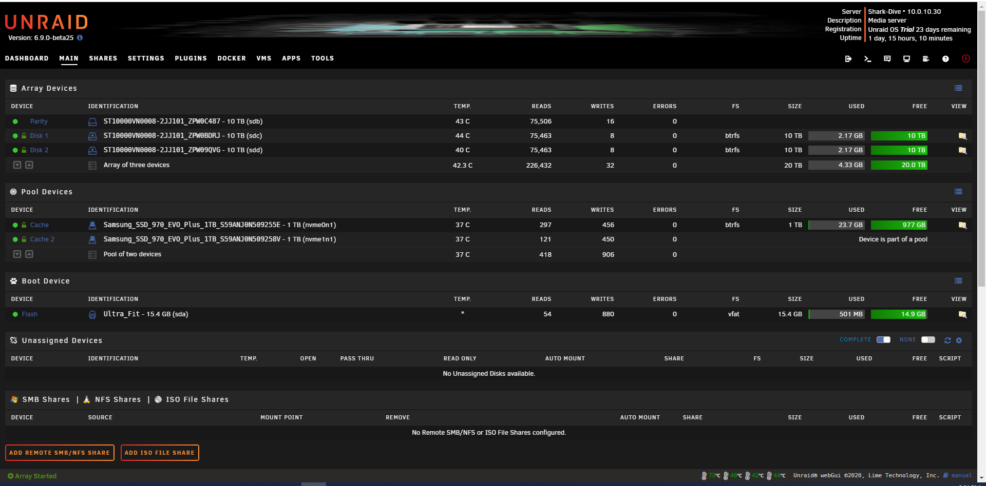

Could you post a screenshot of the entire MAIN GUI tab?
According to your diagnostics you don't have any user shares. I don't use encryption so I don't know what is going wrong with your encryption that is preventing user shares from working. Have you actually unlocked your disks?

Attached screenshot of Main Page as requested

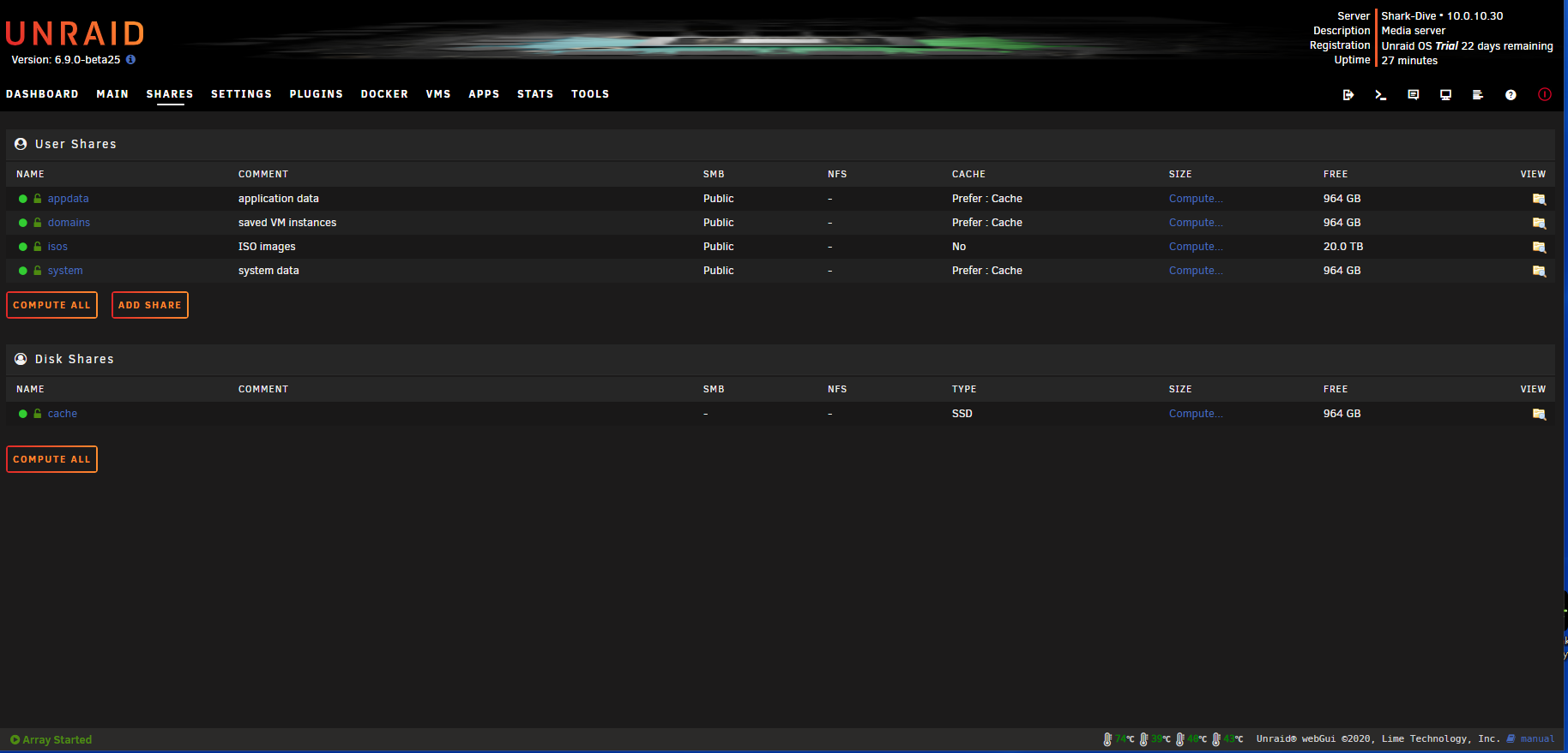

As the screenshot above shows the appdata, domains, system, & isos still are not appearing in the User Shares. So as you said probably got broken when was having issues getting the encryption started. Is there a way to fix it or doesw it take a re-install?

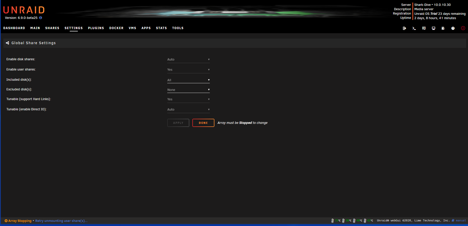

I'm not entirely sure why cache is a disk share. I recommend not sharing any disks on the network. Stop the array then go to Global Share Settings and post a screenshot.
I can turn that off, just was what came up as a default in the system, hadn't seen anything that indicated what to change from defaults. Still in the process of creating everything and working on getting dockers & vms determined, etc.
Seems to be stuck trying to shutdown the array. Here is the current screenshot of the Global Share Settings as requested however the array is having problems shutting down. I'll check on it in a little while to see if it finally shutdown.

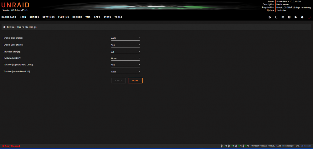

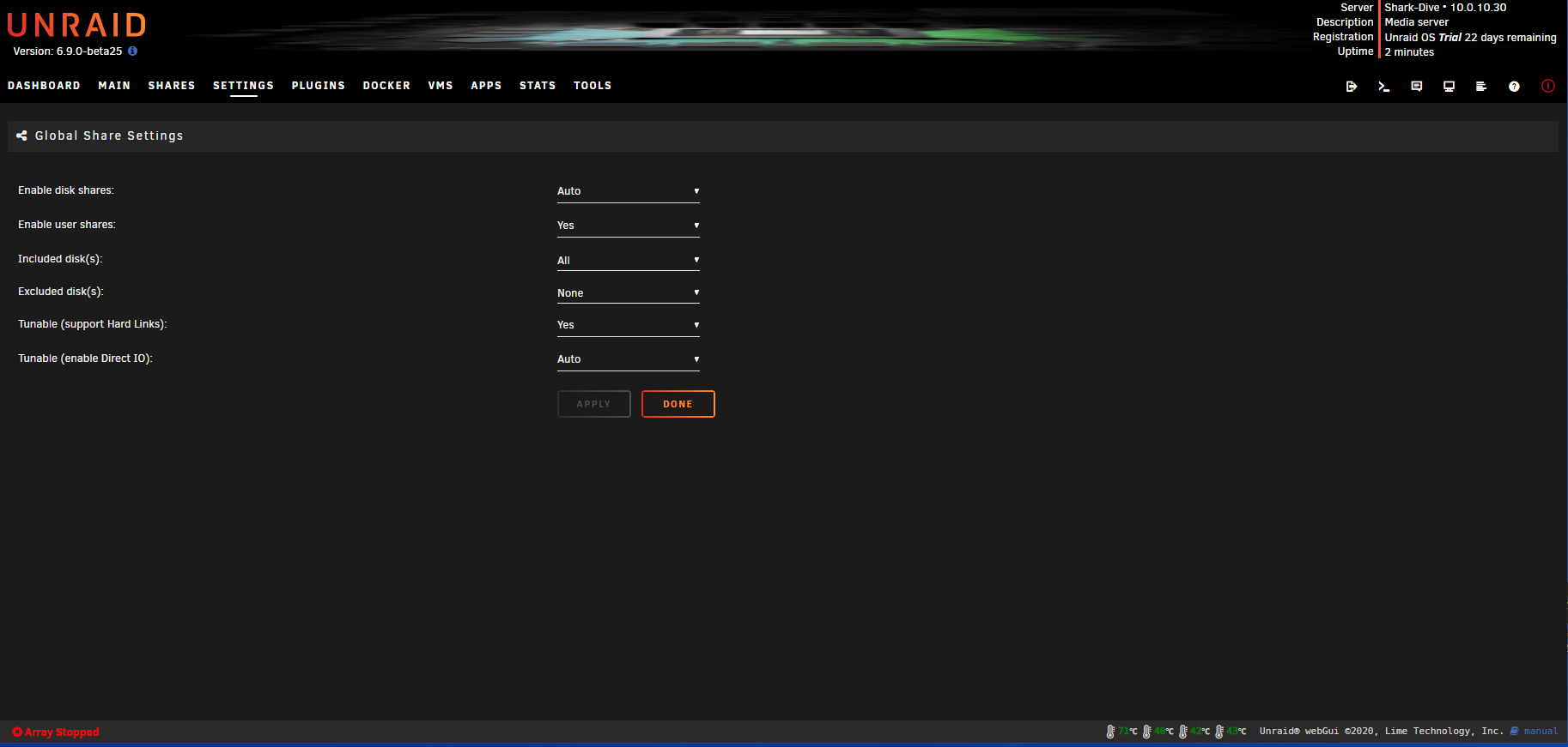

So ended up rebooting to get the array to stop, here is the screenshot of the Global Share Settings with the array stopped.

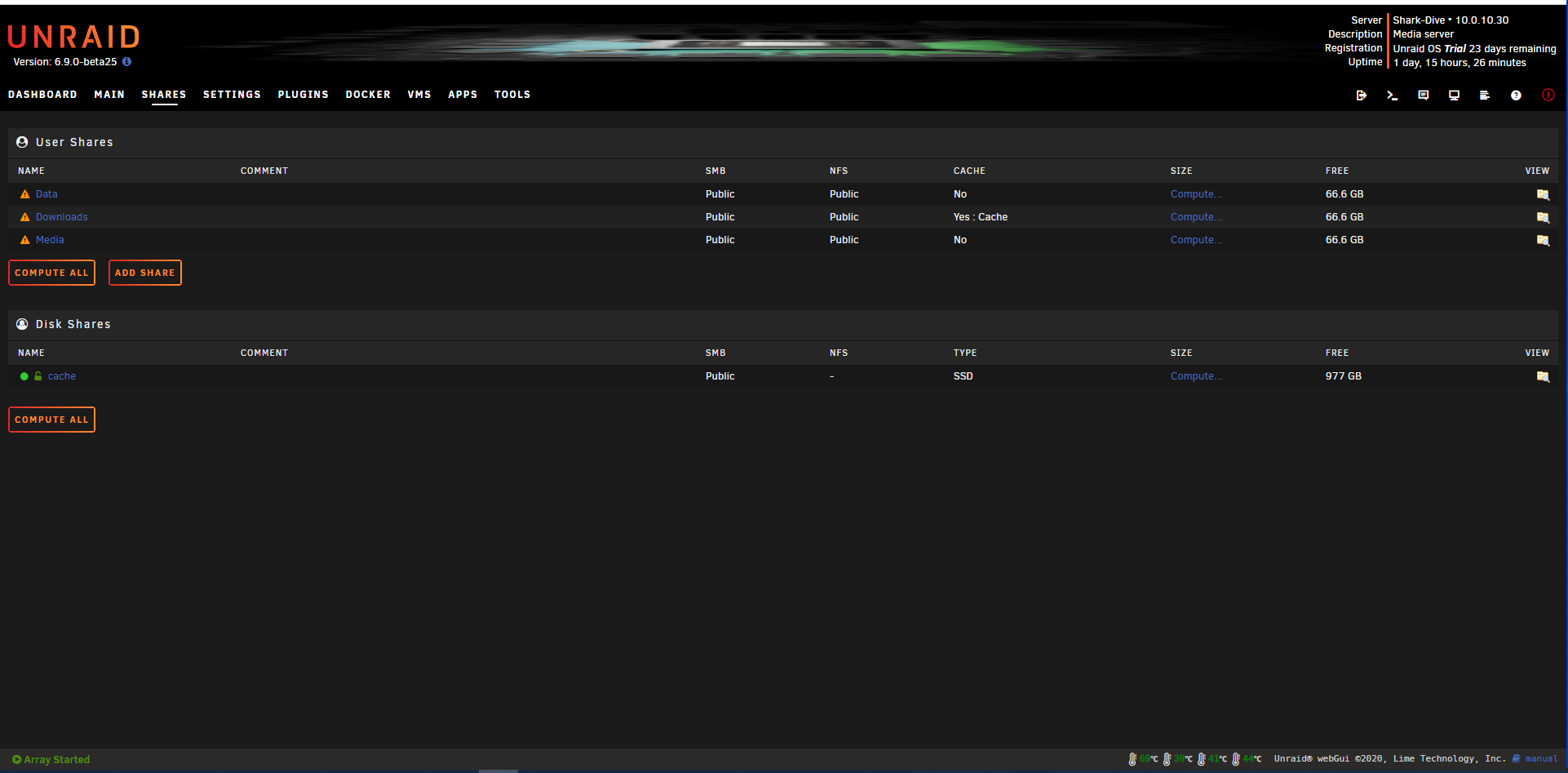

SO this is starting to get funny, on 8/1 I had created several shares and they were the only ones appearing: Downloads, Data, & Media. The "standard" user shares were not appearing in the User Shares (appdata, domains, isos, system). After several reboots, now the standard User Shares are appearing but the Shares I added no longer appear.
Finally got the other Shares recreated, a successful Stop of the Array and restart and all the shares are still there. Whoo hoo. WOrking on getting connectivity from my laptop to shares.
