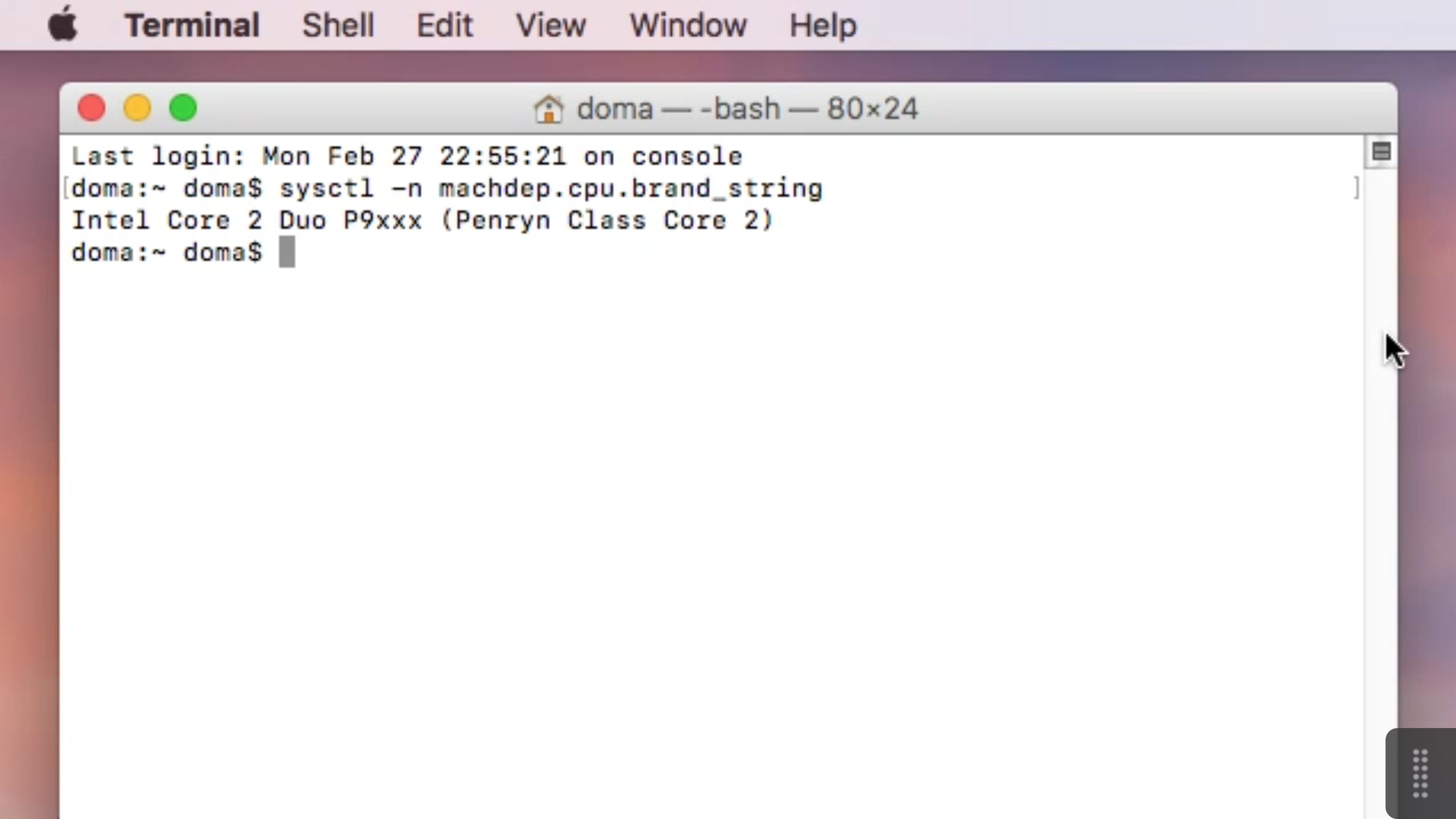

@gridrunner could you please run this command
sysctl -n machdep.cpu.brand_string
..to see if it display correct cpu model.Thank you

Mine, displayed xeon, however I started from El capitan since my mac cannot be upgraded to Sierra
