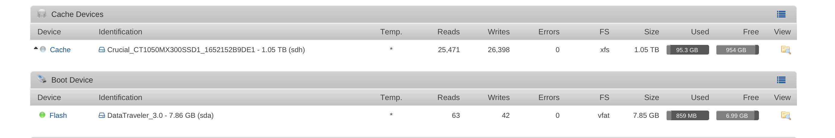

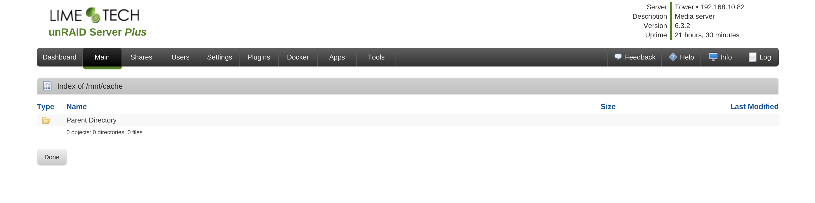

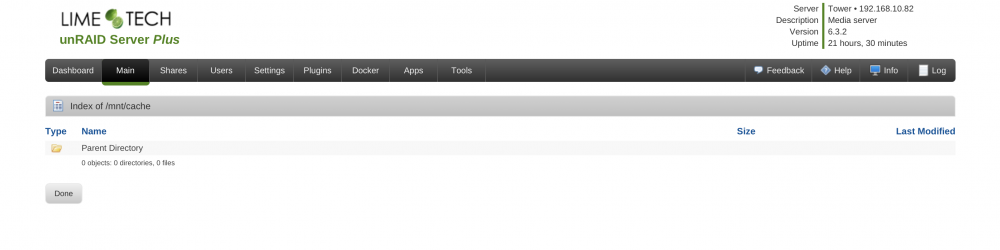

I tried to delete my docker and recreate it but still getting errors as well getting a bunch of other errors that are concerning, wondering if I am having motherboard issues. Its weird that there are errors relating to BTRFS when the cache was reformatted to XFS. The error below causes my cache drive to show no directories on it, shows normal on the main page but click on the directory and it shows nothing is on it.

Sorry this is the start of the error I meant.
Feb 21 19:19:36 Tower kernel: blk_update_request: I/O error, dev sdh, sector 1026147647
Feb 21 19:19:36 Tower kernel: XFS (sdh1): metadata I/O error: block 0x3d29c4ff ("xlog_iodone") error 5 numblks 64
Feb 21 19:19:36 Tower kernel: XFS (sdh1): xfs_do_force_shutdown(0x2) called from line 1200 of file fs/xfs/xfs_log.c.  Return address = 0xffffffff812b37d1
Feb 21 19:19:36 Tower kernel: XFS (sdh1): Log I/O Error Detected.  Shutting down filesystem
Feb 21 19:19:36 Tower kernel: XFS (sdh1): Please umount the filesystem and rectify the problem(s)
Feb 21 19:19:36 Tower kernel: sd 7:0:0:0: [sdh] tag#7 UNKNOWN(0x2003) Result: hostbyte=0x04 driverbyte=0x00
Feb 21 19:19:36 Tower kernel: sd 7:0:0:0: [sdh] tag#7 CDB: opcode=0x2a 2a 00 01 ba 3c 98 00 00 10 00
Feb 21 19:19:36 Tower kernel: blk_update_request: I/O error, dev sdh, sector 28982424
Feb 21 19:19:36 Tower kernel: sdh: detected capacity change from 1050214588416 to 0
Feb 21 19:19:36 Tower kernel: Buffer I/O error on dev sdh1, logical block 3622795, lost async page write
Feb 21 19:19:36 Tower kernel: Buffer I/O error on dev sdh1, logical block 3622796, lost async page write
Feb 21 19:25:28 Tower kernel: blk_update_request: I/O error, dev loop0, sector 175584
Feb 21 19:25:28 Tower kernel: BTRFS error (device loop0): bdev /dev/loop0 errs: wr 0, rd 1, flush 0, corrupt 0, gen 0
Feb 21 19:25:28 Tower kernel: blk_update_request: I/O error, dev loop0, sector 2272736
Feb 21 19:25:28 Tower kernel: BTRFS error (device loop0): bdev /dev/loop0 errs: wr 0, rd 2, flush 0, corrupt 0, gen 0
First error looks like a hardware issue (bad cache device or bad cable/controller), it dropped offline, so all the other errors are related, including the btrfs errors because the docker image is not accessible anymore.
