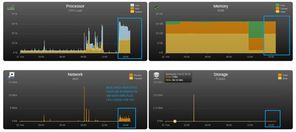

I have been having issues lately with both high disk and CPU usage in any VM, this makes the VM unusable, to try and resolve my issues I have done the following troubleshooting.

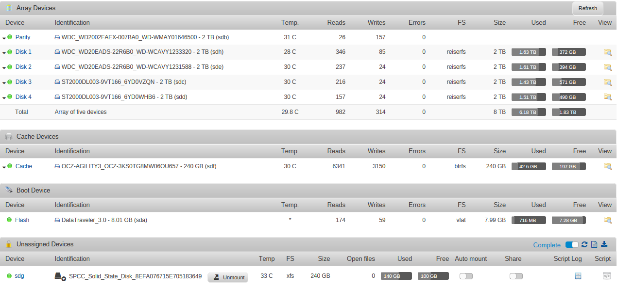

TRIM SSD's which were used for cache pool
Gone back to 1 SSD cache and 1 as Unmounted device, tested with vdisk on either drive
Created a new vdisk for Windows 10 VM and Ubuntu VM, no change in performance on either SSD
Ran 3 passes of Memtest, no errors
Followed all CPU pinning guides on this forum, isolated Cores for VM use only, pinned other cores to Dockers and unRAID
VM cores 4,5,10,11
unRAID 0,6
PLEX 3,9
Sonarr 2
CouchPotato 3
Sab 1,7
I have attached my diagnostics file along with screenshots of various troubleshooting steps, any and all help appreciated.

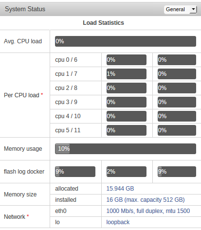

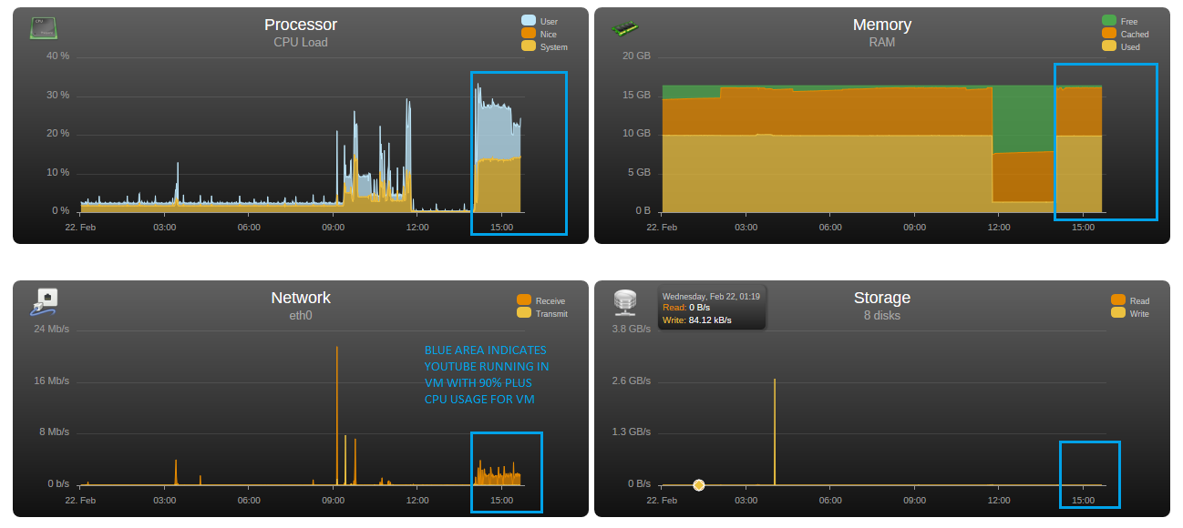

install dynamix system stats and post a screen shot of disk usage when 1 is running. also post a screen shot of dashboard load statistics when it is running as well.

I have added a screenshot from system stats tool, the area marked in the blue square indicates the time Youtube is running very poorly on the VM and the VM has over 90% CPU usage in Task Manager.

every 60 seconds it shows "md: unRAID driver removed" then reimport the drives. I don't know if this is related to your issue, but it probably isn't good either way.
But the following lines are probably more important to your vm issue:
Feb 20 20:17:39 Wedge_Server kernel: TSC synchronization [CPU#0 -> CPU#1]:
Feb 20 20:17:39 Wedge_Server kernel: Measured 4249343731670466 cycles TSC warp between CPUs, turning off TSC clock.
Feb 20 20:17:39 Wedge_Server kernel: tsc: Marking TSC unstable due to check_tsc_sync_source failed
Feb 20 20:40:50 Wedge_Server kernel: kvm: SMP vm created on host with unstable TSC; guest TSC will not be reliable
Feb 20 20:40:52 Wedge_Server kernel: pmd_set_huge: Cannot satisfy [mem 0xe0000000-0xe0200000] with a huge-page mapping due to MTRR override.
What does it imply? no idea.... but it doesn't show up in my logs. A quick search of the unraid forum shows inconclusive findings.... everything from bios updates to possible motherboard or cpu failure, to nothing. I don't know where to go from here.
Edited by 1812
Many thanks for the digging, not sure what the unRAID driver removed error is all about either, like you said, probably not good.
The other issue with the CPU is of more concern, I will have to dig a little deeper into it, I guess a BIOS update is the easiest thing to try first.
So I upgraded the BIOS to the latest version and this has resolved the issue for some reason, I do not understand why but many thanks for the suggestions.
Perfectly normal when the array is stopped.
Well thats good too hear, I think it is all resolved with the BIOS update.
When in doubt, check for BIOS updates!  That's the lesson learned today!
