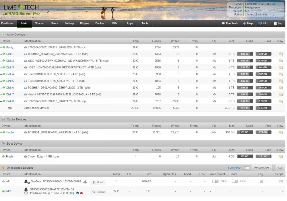

I was able to resize the cache (sdk) to 894gb to match the SSD.  I followed the steps to clear the FS on the SSD (sdl).  I am unsure of how to start the cache replace.  I think I need to add the ssd to the cache pool, but I am unsure.  Can you confirm what I do next?
Attached my main screen.
Leave it unassigned and use method 1 from this procedure, if replacement is cleared start on step 2.
PS: It usually better to make the old disk smaller than the new one, if you still get a "replacement is smaller error" resize again to be smaller than new SSD, you can then resize the new device to max space in the end.
