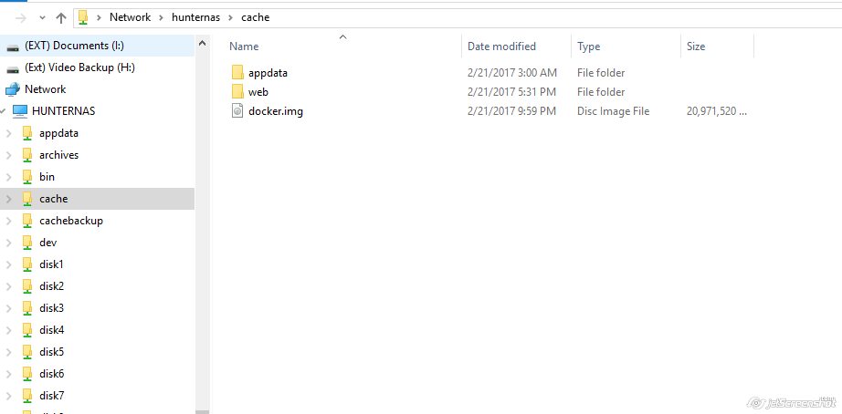

Yet, windows can see the directory...

Interesting, it states that the directory does not exist?!?
root@HunterNAS:/# ls -al /mnt/user/cache/bin/ls: cannot access '/mnt/user/cache': No such file or directoryroot@HunterNAS:/# cd /mnt/userroot@HunterNAS:/mnt/user# cd cache-bash: cd: cache: No such file or directoryroot@HunterNAS:/mnt/user# lsDocArchive/   README        cachebackup/           docs/             installgl.debug  movies/    usr/Dropbox/      UPGRADING     changelog              etc/              installgl.sh*    music/     web/ISO\ Files/   appdata/      convert_to_2.0.pl*     ftp-data/         jwhbackup/       pictures/LICENCE       archives/     create_server_key.sh*  gcp/              lib/             site/My\ Backups/  autoinst.sh*  dev/                   glftpd.conf.dist  lib64/           sitebot/Pydio/        bin/          docker.img             home\ movies/     libcopy.sh*      tv/root@HunterNAS:/mnt/user# cd cache-bash: cd: cache: No such file or directoryroot@HunterNAS:/mnt/user#
Sorry meant /mnt/cache

Sorry, I should have seen that too...
root@HunterNAS:/# ls -al /mnt/cache
total 20971536
drwxr-xr-x  1 nobody users          40 Feb 21 21:00 ./
drwxr-xr-x 15 root   root          300 Feb 21 18:18 ../
drwxrwxrwx  1 nobody users         330 Feb 21 03:00 appdata/
-rw-rw-rw-  1 nobody users 21474836480 Feb 21 22:39 docker.img
drwxrwxr-x  1 nobody users           0 Feb 21 17:31 web/
root@HunterNAS:/#

I'm not sure why there's a docker.img and /appdata are in this directory (and current date/time) as I have that setup to backup elsewhere.  The destination share in settings for appdata backup/restore is cachebackup/current/...and that directory is full of current files...
Because they are in /mnt/cache they will show up in /mnt/user as well.
You really should turn off your disk shares.
Can you give us a good explanation of why you think you need disk shares and user shares both?
I never use disk shares myself.
