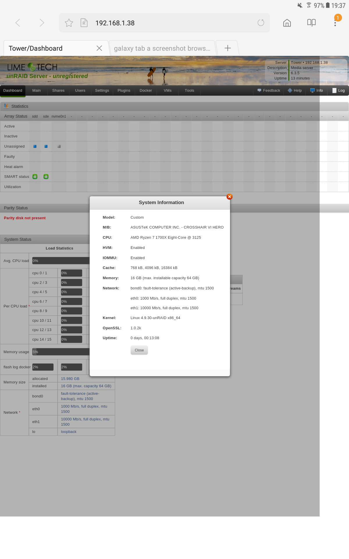

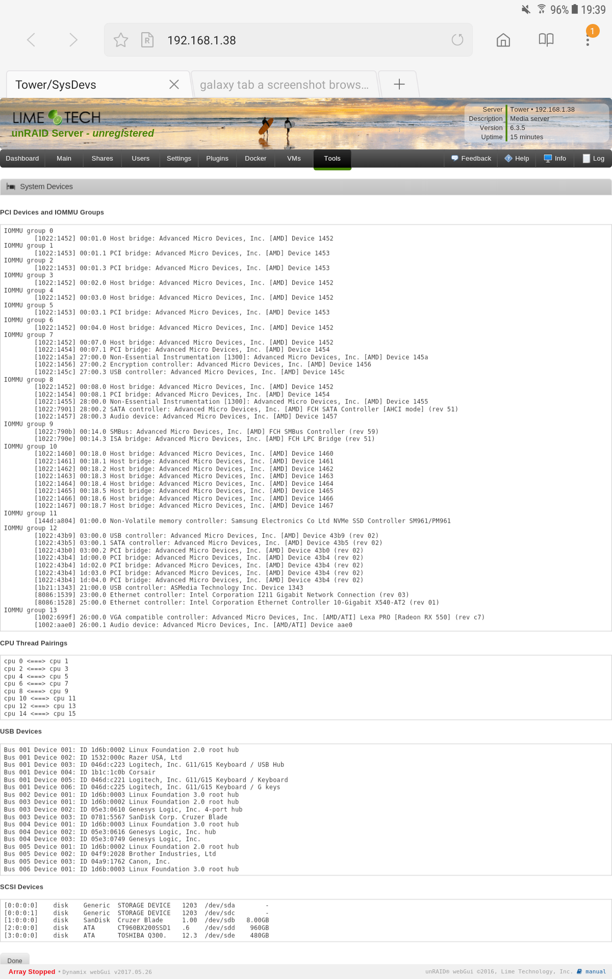

Screenshot_20170702-193736.thumb.png.9592e0e48c18ce5b94de2e166bd5da12.pngUpdate- running the latest bios 1403 for asus crosshair vi.  Has the agesa 1.0.0.6 in it this time.
Havent had much time to test but planning on switching over this week.
One anoying issue i have after using the system and rebooting from a cold start  the board just errors most of the time with a different error code. I still cant put my faith into this board holding my array . Anyone else suffering similar issues?
Considered RMA but the hoops that asus makes u jump thru is a joke. Registered the board on my asus account but still cant get anywhere witht return process.
Edited by Akio

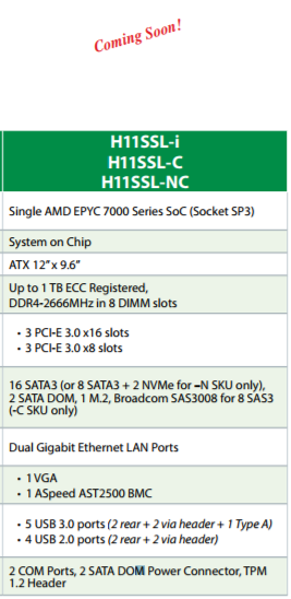

Supermicro announced the new AMD server boards, I find the H11SSL series particularly interesting, 16 SATA + 8 SAS ports on some models!
Pretty impressive!
If/when Ryzen becomes fully stable for unRaid (including passthrough), these motherboards are going to here very popular here!
The dual Ryzen board with 10G lan and 4T of memory also pretty interesting. Mini-mainframe!
Wow, very interesting!  Some napkin math (hope I didn't make any mistakes...):
The 8-port SAS controller is the Broadcom SAS3008, which is an 8-ports 12Gb/s controller.  That means it provides switching capability of up to 96Gb/s, aka 12GB/s.  It can address up to 1,000 devices.
Unfortunately, it only has 8 PCIe 3.0 lanes, providing a total of 7.9GB/s max throughput, so it limits the SAS controller's max throughput.  Would have been nice to see a 16 lane controller chip, especially since EPYC has lanes galore.
Using 4x port multipliers, the SAS3008 could easily support 32 drives with almost 250MB/s available throughput per drive.  For mechanical spinning HD's, that should be sufficient.  I think there are some server cases that include port multipliers on the SAS backplanes.
If I'm interpreting the specs correctly, the H11SSL-NC combines the SAS3008 controller with 8 SATA + 2 NVMe, so you could use the SAS3008 for all array drives, the 2 NVMe for a high-speed mirrored cache, and pretty much ignore the 8 SATA ports.
Would love to see something similar on a Threadripper board.  EPYC solutions are going to be way too expensive for my tastes, even at less than half the price of comparable Xeons solutions, and the 16-core lower-end EPYC models have pretty low clockspeeds.
