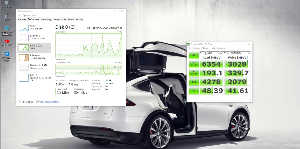

This is what i get when running crystaldiskmark on my 64bit windows 10. As you can see the response time is crazy slow1a279d735d31f4085cf3fa66bf2eb456.png

Mine isnt like that. I run a windows 10 vm from a raw vdisk file thats on a unassigned SSD in my system.. Also my disk is read as a VirtIO SCSI Disk and yours is just a QEMU Hard disk. Maybe thats the difference. 176905913_Screenshot2018-05-09at5_17_53PM.thumb.png.f468c3c68d82237b95d1e743b5424cbd.png
Ok after a bit of testing i get a bit of jitter too...gonna see if i could tweak some things to work it out.
Ok try setting the xml for your vm like this. Set the cache part to none instead on writeback.
<driver name='qemu' type='raw' cache='none'/>
This seems to kill the stuttering for me.

@david279 Thanks for the help but no dice. I've tried;
* Changing the currrent VM to Q35 - still same issue
* Changing bus to VirtIO - won't even boot
* Reinstalled windows with Q35 and disabled cache - still same issue
* Reinstalled windows with i4 and disabled cache - still same issue

Not optimal, but trouble-shooting hardly is, have you tried setting up Windows on that drive and with this board as "bare metal" to see if it's hardware or combination of hardware causes the issue? Or was this your old gaming system, or similar, and hence you already have an idea of what the benchmark numbers should look like on bare metal? Perhaps it's failing hardware? I don't know the age of these components, so I'm just asking from perspective of general troublehooting - as my Linux Kungfu isn't as strong.
What version of the Redhat VirtIO drivers are you running in Windows? That's the first time I've seen QEMU listed in windows (from my own vm dealing at least).
Edited by Jcloud
You need to create the VM using virtio from teh beginning.
Sent from my SM-G955U using Tapatalk

Good shout, will likely try that tomorrow. I think i did this before and didn't see the issue then. But i don't think i looked at the average response time but went more on feeling. Passing the ssd through like i do makes it possible to also boot on the SSD directly. But don't want to disturb peoples plexing right now :)
For ultra-paranoid, and to make sure nothing happens with that array data, on the power-off you could physically disconnect the power for the drives in your array, just so Windows doesn't see it and nothing happens to data.

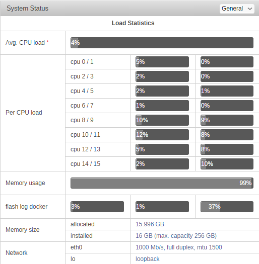

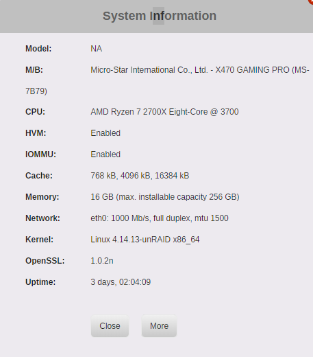

Recently i upgraded my intel i5 gen 4 platform to an ryzen platform:
AMD RYZEN 7 2700X sAM4 +Wraith
16GB 2x8GB CMK16GX4M2B3000C15
MSI X470 GAMING PRO Mobo
Ive been using unraid with my i5 gen 4 for more than 2 years now without any issue. And im very pleased that the upgrade was seamless. After connecting the new hardware to my 'old' cache ssd array and hhd storage array and using the same unraid pen drive image, everything booted without issues. I have running on top of the unraid os (v6.4.0):
krusader
netdata
pihole
2x tonido cloud server
2x windows 10 vm with dedicated gpu
bunch of user utilities
On the bios (latest version) did left it almost at default settings. XFR enable ( mem running @ 3GHz ) , AMD cool and quiet enable ... So all ryzen firmware oc features are enable and working well, the grep MHz command shows cpu core speed varying from 2.2GHz up to 4.25GHz :)
Relative to power consumption i have not noticed any relevant change.
The system is currently up and running for more than 3 days, no issues.
The only downside i have up to this moment is not knowing the system / core temperatures (x470 is still very recent), fan speed is looking good (not worried about it, great stock cooler ).
Here are some prints:
Regards.
Edited by react

I can't believe that there isn't more discussion on this, as it certainly caught my attention.
I have an 1800X, and my individual core's max out at 3.6GHz with unRAID, even when only a single core is loaded.
I always figured that this was just a limitation of Linux, as in earlier testing I saw 4.1GHz in Windows.
Now react comes along and shows boosting working perfectly on a 2700X, what's up with that?
While I know that the 2xxx series on the X470 motherboards adds Precision Boost 2 and XFR2, these simply permit more aggressive boosting when more cores are loaded, and shouldn't be required for boosting when only a single core was loaded.
I never see over 3.6GHz (I don't manually overclock).  Is this the same experience of other Ryzen 1 users?
Is there a change in Ryzen 2 or X470 that fixes this issue, or a system setting or BIOS setting I might have wrong?
Paul
