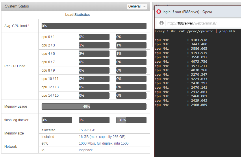

react, since you have a 2700x, what do you get for this command?
root@Tower:~# cpufreq-info
cpufrequtils 008: cpufreq-info (C) Dominik Brodowski 2004-2009
Report errors and bugs to cpufreq@vger.kernel.org, please.

Hello all,
Paul running the cpufreq-info i get the following (on all cores):
Ill try to dig into this a bit more over the weekend (post some bios screenshoots), but basically its all defaulted, yes SVN is on (or no vm), default was inactive.
I believe (not sure) the boost is all done in firmware nothing to do with the OS, at least on Ryzen 2. It may well be the XFR2 because its more linear (more resolution/interpolation) it scales better on a linux OS. Windows may push XFR1 to max but not linux (just wondering) ...
And im using CPU Scaling Governor: Conservative on the unraid. Changed it to performance but did not notice any change (but cannot guarantee as i was just trying to spot changes using the grep command) ...
Regards

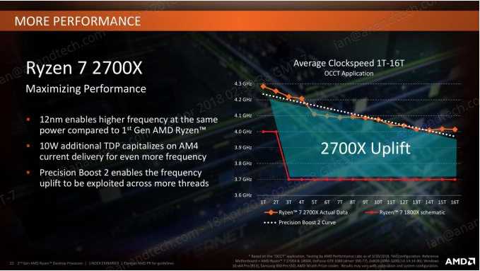

Hello all,
Relative to the subject of Ryzen 2 oc vs Ryzen 1 oc i believe the next graph shows the reason:
Ryzen 1 users are reporting on unraid only getting 3.7Ghz max, that kind of make sense since unraid (when loaded with other stuff, mainly vm) will always use more than 2 threads. One way you guys can test this is to unload everything from unraid, and do cpu stress test on unraid itself and check if 1 or 2T can boost to 4GHz (if unraid does not spread the load anyway). This would have to be done as Paul proceeded in removing the Linux CPU Freq scaling driver (as i believe is useless with Ryzen). Also we would need a better way to benchmark instead of getting only instantaneous GHz reading with grep it would be great to get session min/max/avg readings, dont know if that command exists, but it can be created with the grep command in a script file running @ lets say 10ms or even less if possible (it would be handy). If this is the case then its actually a good sign Ryzen 1 users cannot reach 4GHz, meaning unraid is spreading the load evenly across multiple cores, opposite to windows ...
The data that i get in Ryzen 2700x both on unraid and on bare-bone windows 10 matches in perfection the previous graph and i can even see on windows (using hardware monitor) a session max close to 4.35GHz in some cores with the stock cooler. On unraid max that i could spot using grep was around 4.25GHz.
Regards.
I feel that I have essentially already done this test.  With everything unloaded and nothing running, unRAID reports that all 16 cores are idle at 0%.  I can then run a command to load a single core, and it never exceeds 3.7GHz.  I have also repeatedly seen 14 cores idling at 2.2GHz, and the other 2 at 3.7GHz, which seems to corroborate that I am loading only a single core.
I have also used other commands to test frequency, besides grepping /proc/cpuinfo.  So far, the other commands essentially matched the /proc/cpuinfo, and if anything they were slightly lower.  Sorry, I don't have all the commands in front of me, I found them during web searches (supposedly they were more accurate for Ryzen), gave them a try, and moved on.
I certainly agree that, based upon that graphic, the Ryzen 2xxx series will hit higher frequencies with more cores active, which is really awesome.  But that shouldn't change the fact that with only a single core loaded, a Ryzen 1800X should hit 4.0 GHz minimum, and 4.1 GHz with XFR.  Mine never goes over 3.7GHz, which is the same frequency that I can easily hit with all cores using the Performance governor.
Perhaps I am mistaken, and that even when it appears that only a single core is loaded, in reality more cores are active.  In which case, I agree that the graphic perfectly explains what is going on.
Paul
