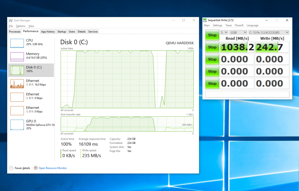

Allright, so i've done some more tests and now i'm even more confused than i were before. To recap, i'm having problems with IO in windows with my SSDs. "Average response time" goes up to 16000ms as seen here (https://imgur.com/a/BMLXHYv).
What i've tested since my last post is:
  • Booting into the SSD directly that i use to pass-through to the VM. Same issue
  • Swapping from connecting the SSD to a sata port on the M/B to connecting the SSD through a LSI 9211. Same issue
  • Clean install a windows VM on my cache drive instead (another SSD drive). Same issue
I've exhausted all the troubleshooting options i can come up with, so any and all ideas are highly appreciated.
Edited by mikegg
