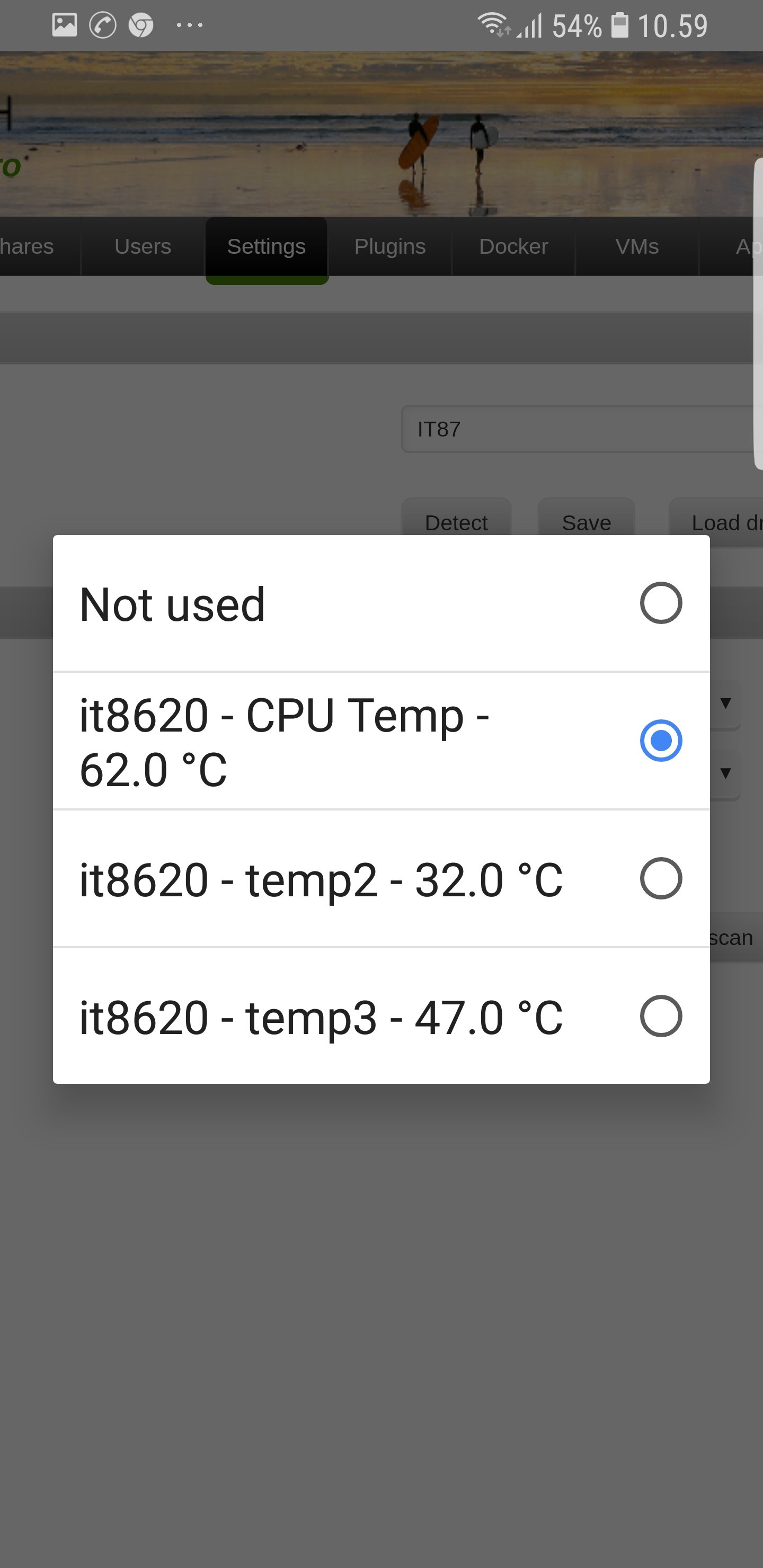

Need to encoding lot off stuff so like to be sure my temp . So I google and read there was no driver whit dynamic temp plugin but you cold use a orther did that . But can only see 3 and one of them are to hot for my liking so are it right or ? (The top hit 80)
Edit
Yes them temp was the same in Windows the stock cooler just get it like that new on the way ?
