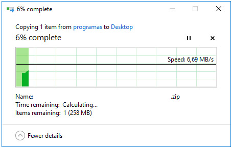

BUT, since I moved to this new case the computer is so slow that makes me sick.
Everything is crawling... file transfers, VMs, browsing on web interface.
