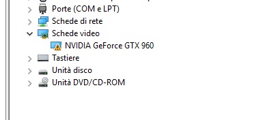

@Gridrunner You are the hero of the day !!
It works great! I confirm that it works with Windows 10 - GTX 960.
Screenshots below! hello and thank you so much !!
1 minute ago, gridrunner said:
Your welcome @steppi, glad it have it working now :)
Thanks, only problem: do not install the drivers GeForce Experience .. Output: Error and installing crash
Some idea? Sorry..

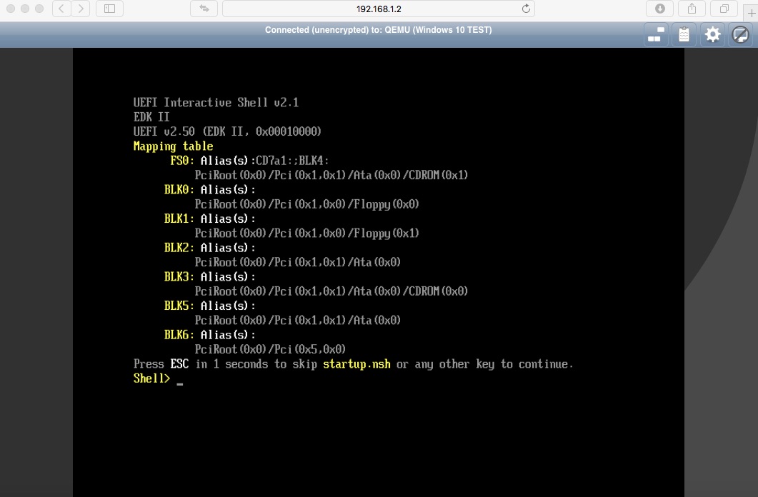

@steppi   I see from your xml you have the VM set up using seabios. I would make a new windows VM and use OVMF for bios type. I find OVMF works far better with passthrough myself. Try that and report back
 @gridrunner I'm sorry, but if I try to install a new vm with bios OVMF comes out this screen ...
What should I do? I'm sorry to disturb you so much, you're too kind!
14 hours ago, gridrunner said:
It looks like the windows that you are installing doesnt support efi boot.
You can download windows 10 from the microsoft website that will support this
https://www.microsoft.com/en-gb/software-download/windows10ISO

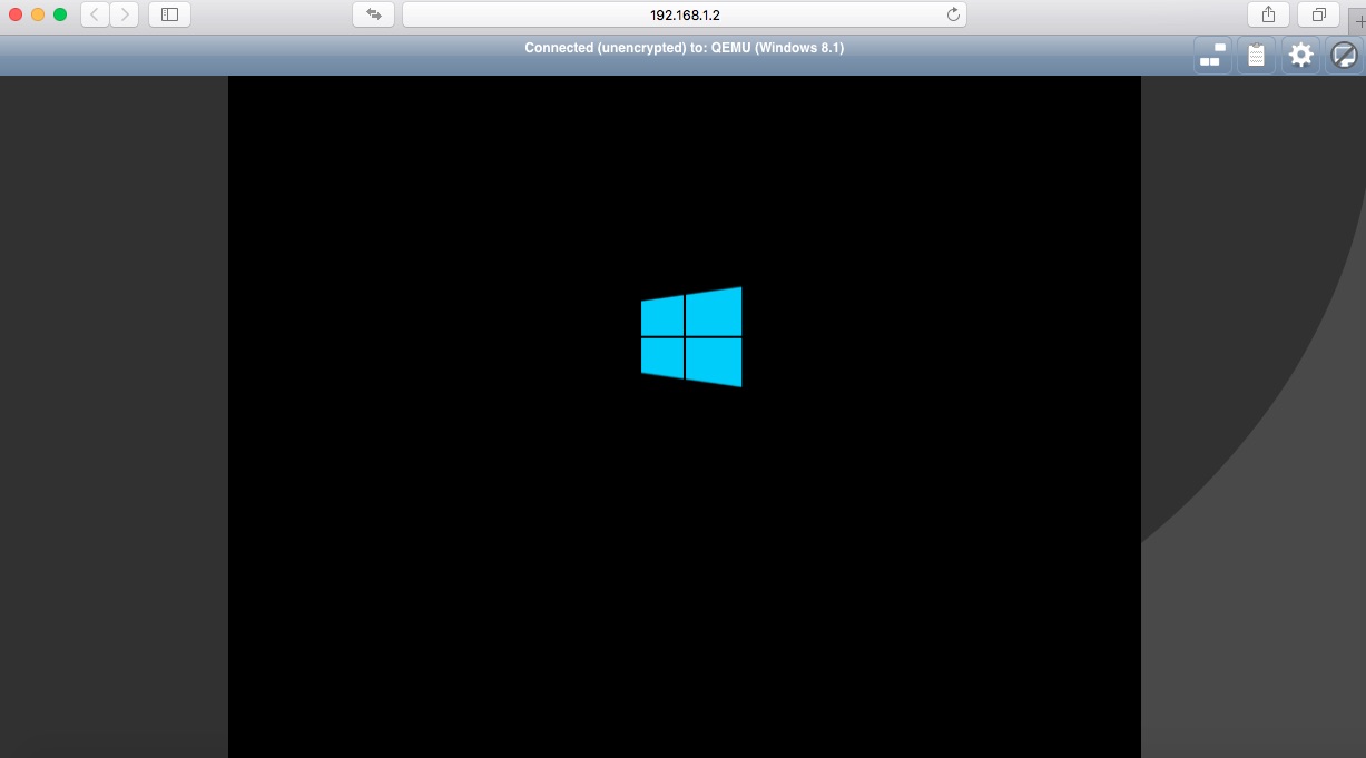

I downloaded the ISO and I find another problem.
As soon as you start the windows installation hangs on the screen as this screenshot:
Some idea?
Sunday I worked a little 'to fix this problem ..
I managed to create a new VM with Windows 10 SeaBios. In fact I was able to install the -NVIDIA Experience- successfully. But going to the Device Management ---> graphics card: Code 43 error.
After I tried to re-open the Nvidia Experience and I find that I am asked again to install the latest drivers, it seems that you do not install the latest drivers.
If I can not install the latest nvidia driver, to release the Nvidia Experience Stream and Nvidia in order to play the -NVIDIA Shield TV- :(

I am not sure why the install hangs when you install using ovmf this shouldnt happen. In the picture you have posted it says windows 8.1, Did you try downloading the latest win 10 iso from the link posted earlier?
Hello! Thank you for having responded to me .. I'm trying to fix this problem for several days ...
I answer point by point:
- MB: ASUSTeK Computer INC. - P7H55-M
- My MB has the integrated GPU, but my CPU Xeon X3440 does not support this function, then the BIOS does not see the GPU function chosen. I can only give priority to PCI or PCI-E GPU ...
- I tried to do the bios dump as you explained you in your video by clicking this file: -Gigabytegtx960_GVN960IXOC_2GD.dump-. I'm not sure it's the correct file because my card is ASUS and Gigabyte not.
How do I know if I did everything right?
- For the Windows installation I solved yesterday, the iso file was corrupted (problem solved).
--- My real problem is the error 43 ---
Thank you for the help you are giving me, you're a good person!
