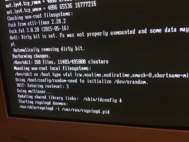

trying to replace cache drive, server won't boot
hi guys, had a great system with an 80gb cache drive.  it was filling up, so today i tried swapping in a 250gb model
did all the mover stuff, to get files off the 80gb cache drive.  then inserted the new.  but system won't boot, hangs at the attached pic.
took unraid flash out, backed up config folder, formatted fresh, then copied over config folder.  but no luck
any advice?

aargh can't believe this!  just exchanged samsung 250 for a wd 250!  and hangs at same screen as picture above!!!

should i leave it at the stage in the picture?  i have left it there about 30 min before shutting down.  could it actually be doing something like formatting?  i don't think so but desperate for an idea....
