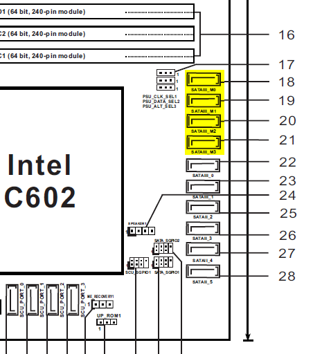

The attached graphics show the Marvel ports on my ASRock - EP2C602-4L/D16 they would probably be the same on a non 4L/D16.

Yes I figured the SATAIII_M1/2/3/4 ports were the Marvell controllers, so I won't use those. I also found out that both my current add-on controllers, SuperMicro AOC-SASLP-MV8 and AOC-SAS2LP-MV8 are also Marvell-based and don't work well with unRAID. *cry*
Ordered two LSI 9211-8i already flashed to IT mode P19 to replace them, and hopefully between that and not using the Marvell ports on my EP2C602 I won't have any other hardware issues.
