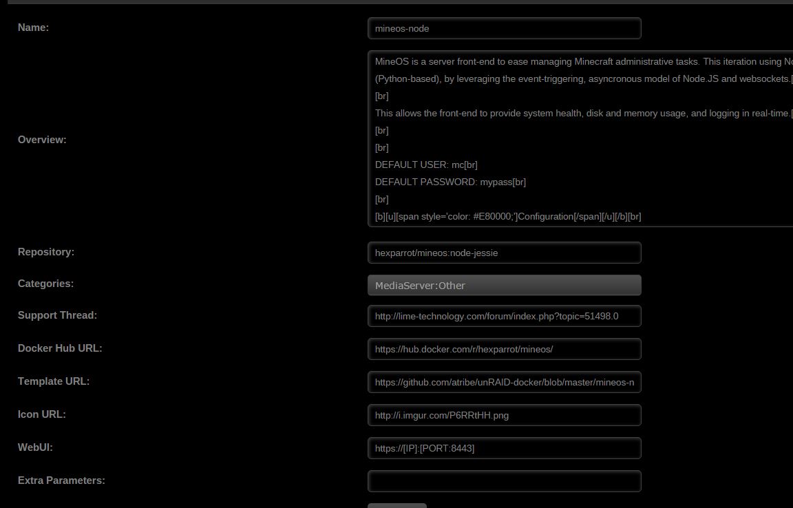

Is it possible to stop the latest tag?
I ran a diagnostic which included a Docker log full of errors when trying to update MineOS. Is it possible to remove the :latest tag that is added at then end when trying to do updates? Below is how its specified in my config.
Also, I cant find this Docker log anywhere in the WebGui?
time="2017-02-27T00:00:04.252412765-07:00" level=error msg="Handler for POST /images/create returned error: Error parsing reference: \"hexparrot/mineos:node-jessie:latest\" is not a valid repository/tag"
What version of unRaid?  And post up the docker run command
Unraid version 6.3.2
Pulling image: hexparrot/mineos:node-jessie:latest
TOTAL DATA PULLED: 0 B
Removing container: mineos-node
Successfully removed container 'mineos-node'
Command:
root@localhost:# /usr/local/emhttp/plugins/dynamix.docker.manager/scripts/docker create --name="mineos-node" --net="bridge" -e TZ="America/Denver" -e HOST_OS="unRAID" -e "USER_PASSWORD"="SpenceR2" -e "ACCEPT_ORACLE_LICENSE"="true" -p 25565-25575:25565-25575/tcp -p 8443:8443/tcp -p 8125:8125/tcp -v "/mnt/cache/appdata/minecraft/":"/var/games/minecraft":rw -v "/mnt/cache/minecraft":"/mnt/data":rw hexparrot/mineos:node-jessie
c031f6f1414dc3504beafe6e4bb36674ddbb49e09501b051f4ec0a784c4c0a04
The command finished successfully!
My bad.  You were talking about updates...  I misread and thought you were doing an install (which worked for you and for me)
