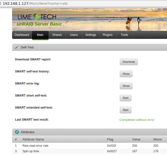

When I click on the drive I get taken to a different page, but "options for that drive, beginning with various partition, file system format, and spin down settings." are not amongst them. Attached is what I see.
According to your diagnostic from yesterday, sdc is your disk1, and the url in your screenshot says name=sdc, but it should say name=disk1. That looks like a screenshot and URL from an Unassigned Device. Have you unassigned your disk1?
*Face Palm* What an oversight. It's now assigned and I now see the option to do xfs_repair.
