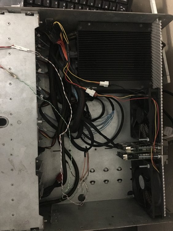

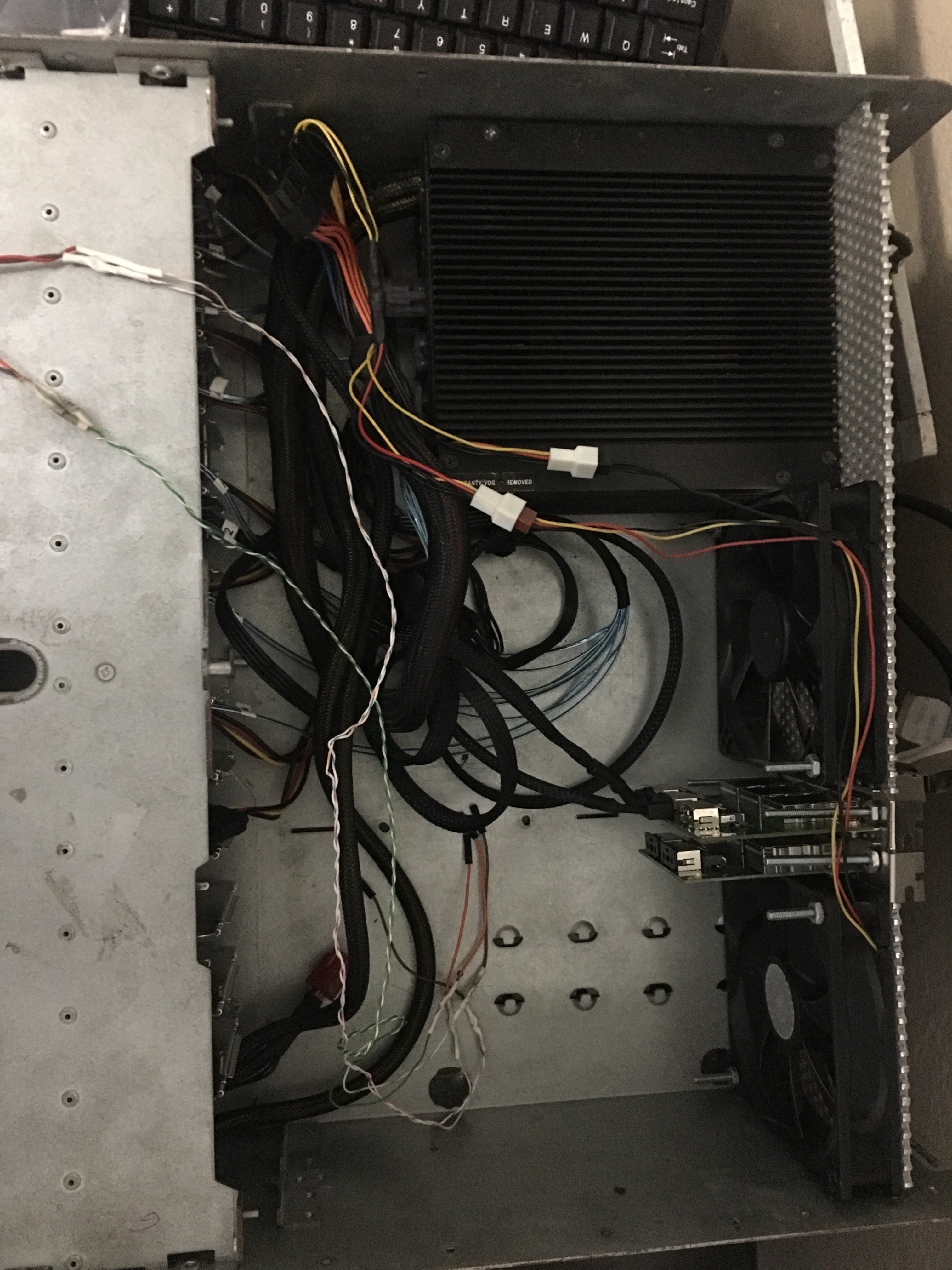

If you don't want to go look through my first post, I basically gutted an Apple Xserve RAID and put in my micro atx board in there with all the hard drives and power supply.

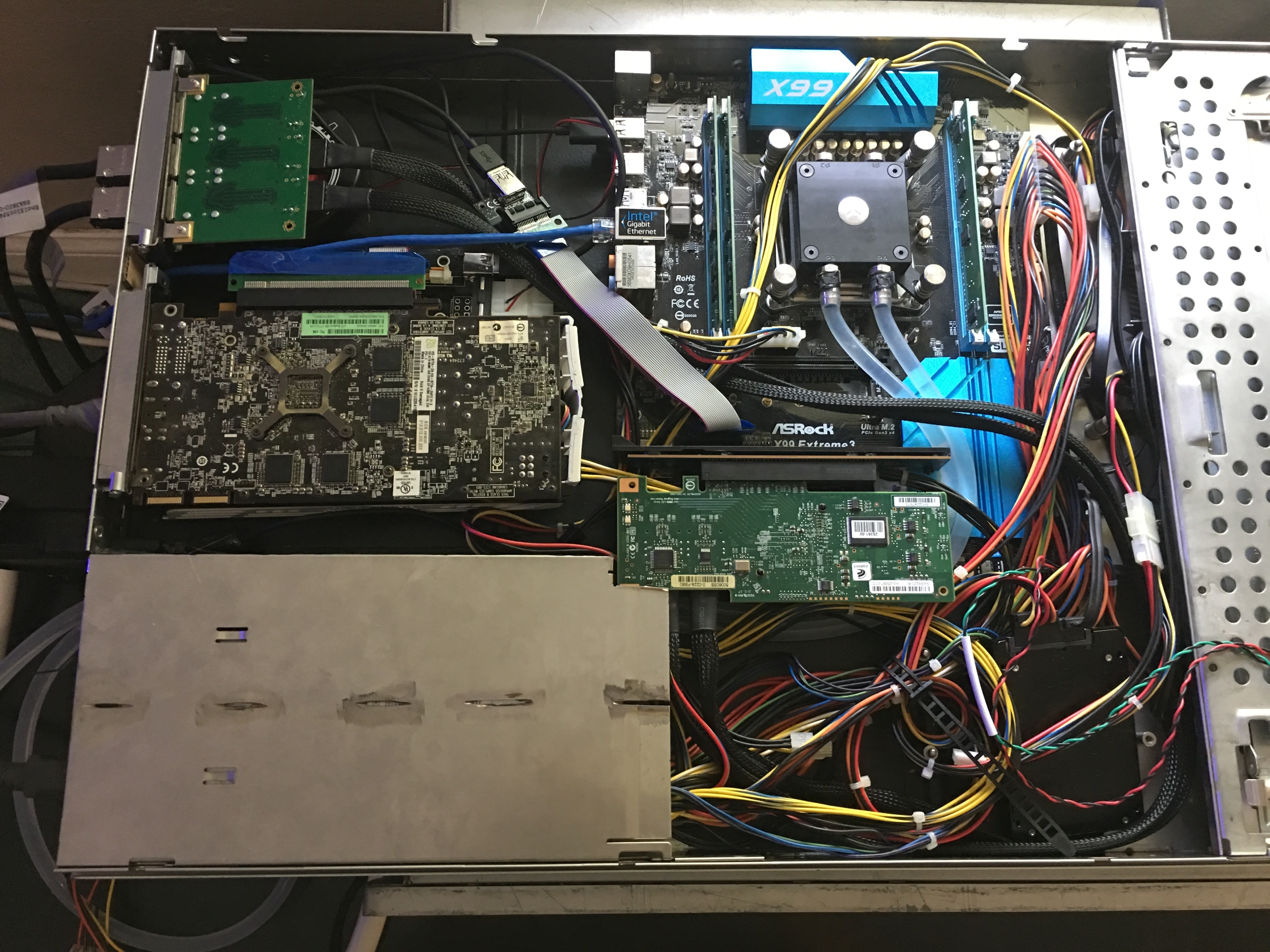

Basically just add a motherboard in the space on the right and a bunch of cables and a ssd laying in there somewhere! But this is what the Xserve RAID looks like now. I removed the motherboard added a fan and the two cards there on the back.
I bought a Xserve 1U case and gutted that to fit my new motherboard and all other components other than the data hard drives which stay in the case pictured above.
It was quite a tight fit with everything in there, and had to use a couple pcie extension cables. I tried to use air cooling at first but just got too hot so the only logical option was to water cool it!! I am using the EK-Annihilator for my cpu block, and it works great! Highest temp I've seen while running at 100% is 50˚C. Oh also I am using a 240mm radiator.
To make the GPU work I had to use a x16 pcie to x1 pcie extesion card with a x1 extension cable that you can see running towards the upper left with what looks like a usb cable on the end. That runs to the x16 pcie to x1 pcie extesion card that is right under the GPU pcie connector. In the top left of the case you can see the 3xSFF-8088 to SFF-8087 card that connects the 8 drives from the other case to my expansion card (can't remember witch one but most people use it). For cooling I have the GPU which is a blower style and a pci blower style fan under the SFF-8088 card. So far I haven't had any cooling problems in the 1U case, or the 3U Xserve RAID case.

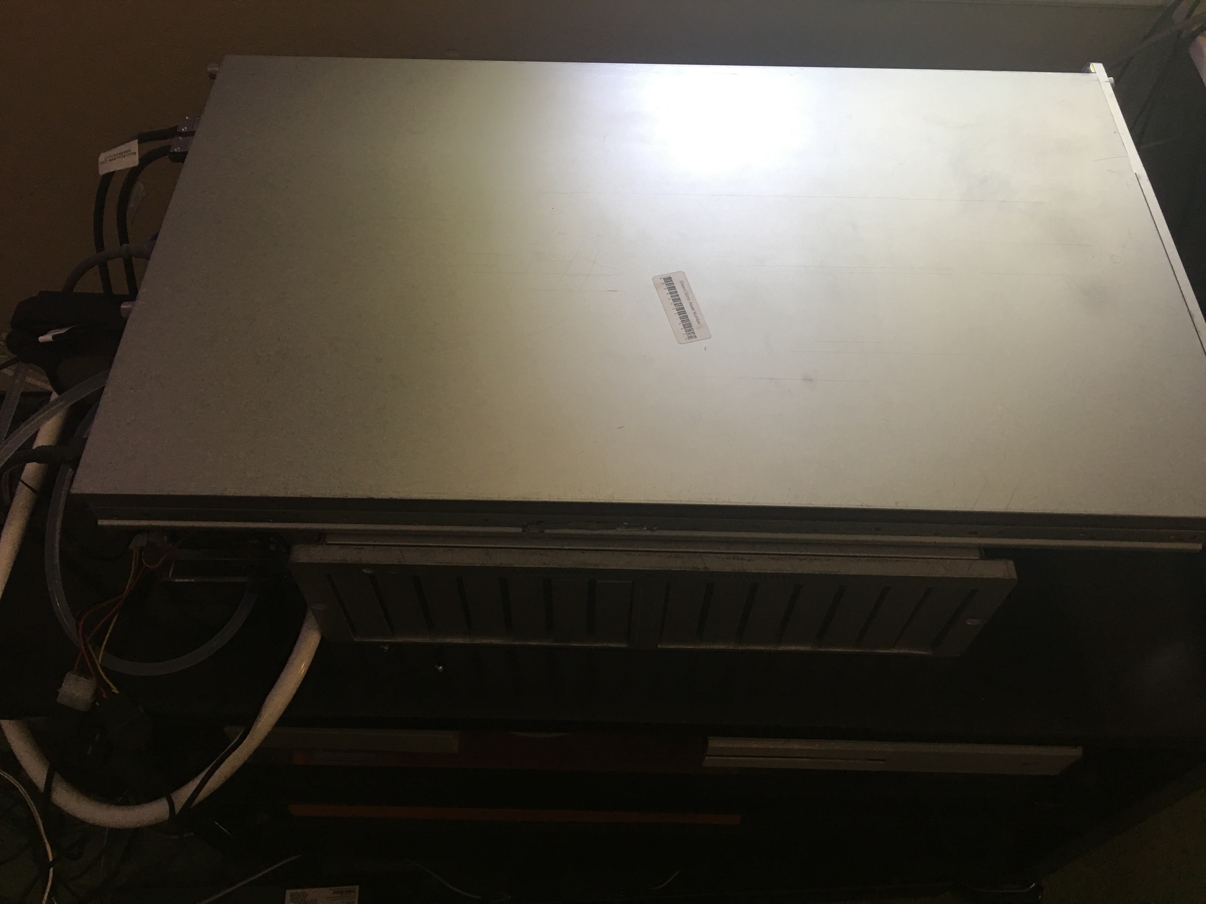

And finally here it is all closed up sitting on top of the Xserve RAID case.
