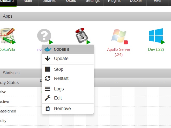

great! i could install it, but how cant i access, it show me "Update" insted of "WebUI" and name is in blue
Edited by tuxevil
cant*
You can edit the container, hit advanced, and under WebUI type in http://[IP]:[80]
