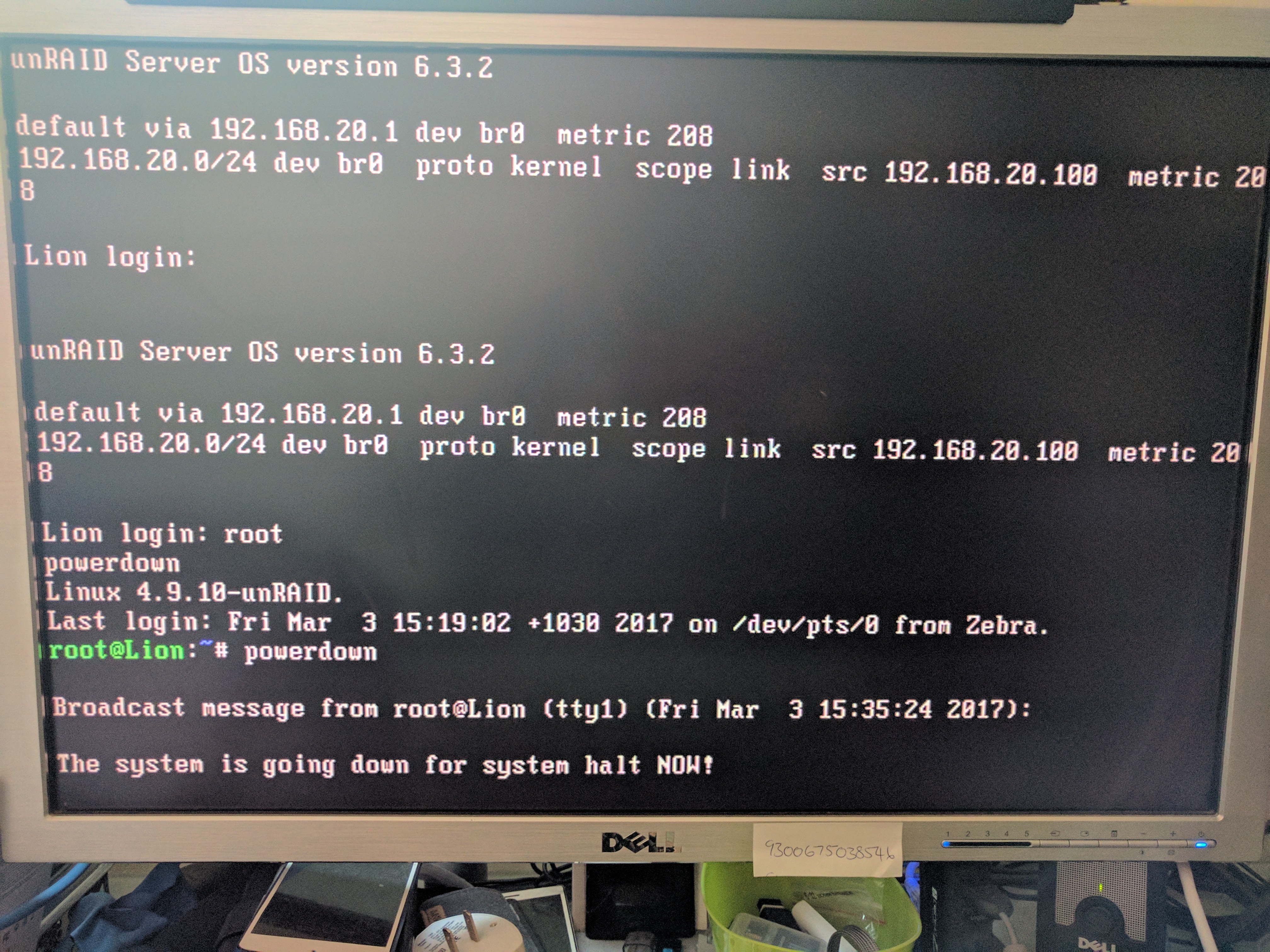

i was able to logon to the console and tried to run the diagnostics again and it just sat there for 20min doing nothing
the only way to get it back is to reset it, from the main console i run the power command and it send the broadcast msg out but it doesnt power it down.

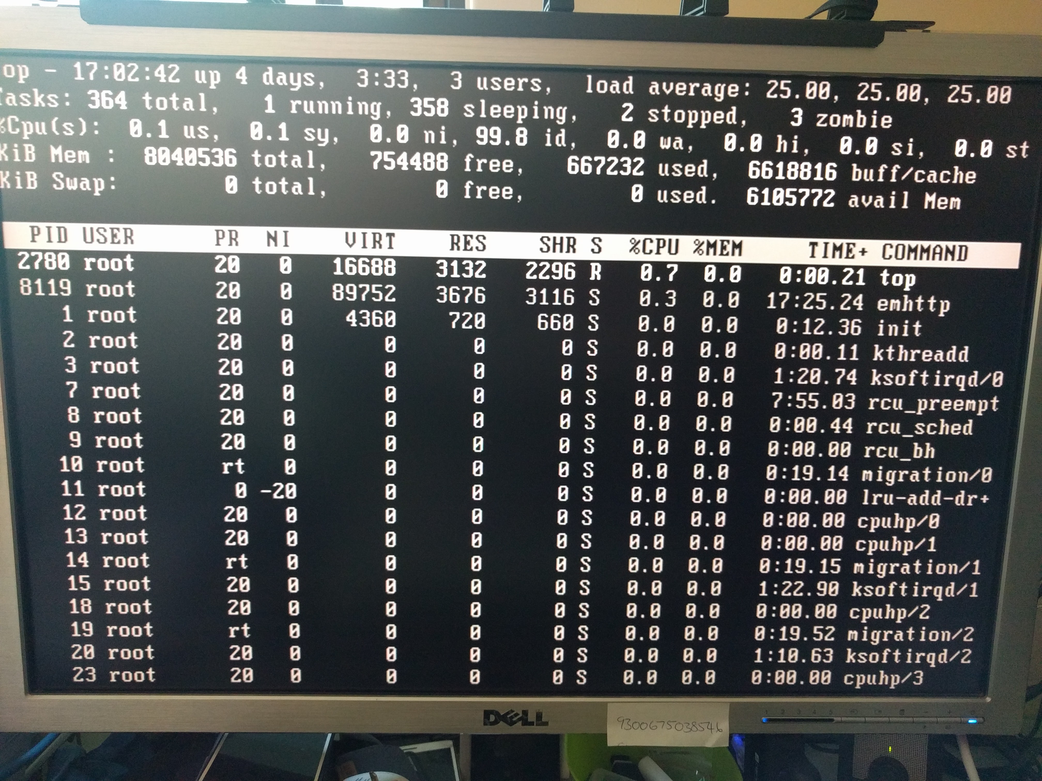

Run top and see if shfs is running at 100%.
Edited by lionelhutz
Nope, shfs isn't even viable

The screens attached to the server was also unresponsive and also showed the same commends at the first pic posted minus the "Fix Common Problems" watches messages.

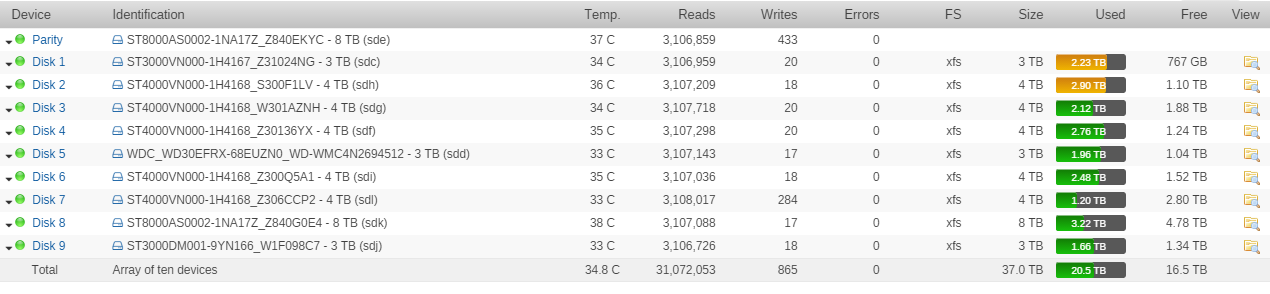

I haven't looked at your logs and its only a guess by me that its a kernel panic, it may not be. I have a hunch that its hardware related though. What disk FS are you using ReiserFS or XFS? Also how much free space do you have on your disks? Not the array as a whole but do you have any disks that are very low on disk space?

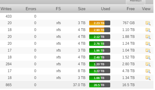

All disks use xfs file system and none are close to being full mas shown below

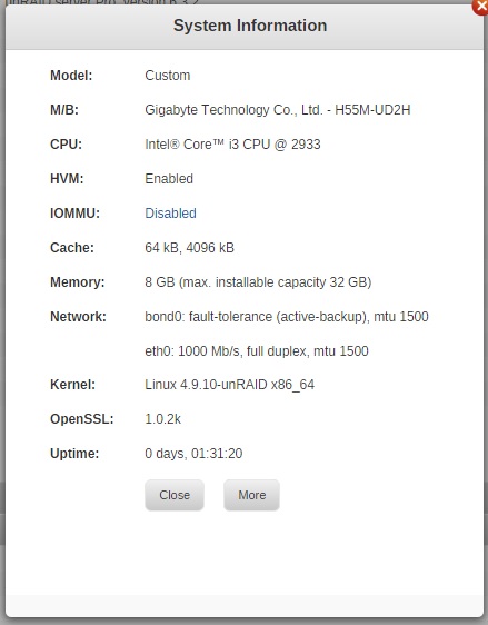

So just to get an understanding of your system, you have the motherboard, CPU, integrated network card I am guessing? What are the drives plugged into? How are system and drive temperatures?
so the drive details are attached, temps are OK as a parity check is running.
yes nic is integrated into the MB, the drives are attached to 2 x 8 port PCI-E cards crossed flash to LSISAS2008: FWVersion(20.00.04.00), ChipRevision(0x03), BiosVersion(07.39.00.00) (1 x IBM, 1 x Dell)

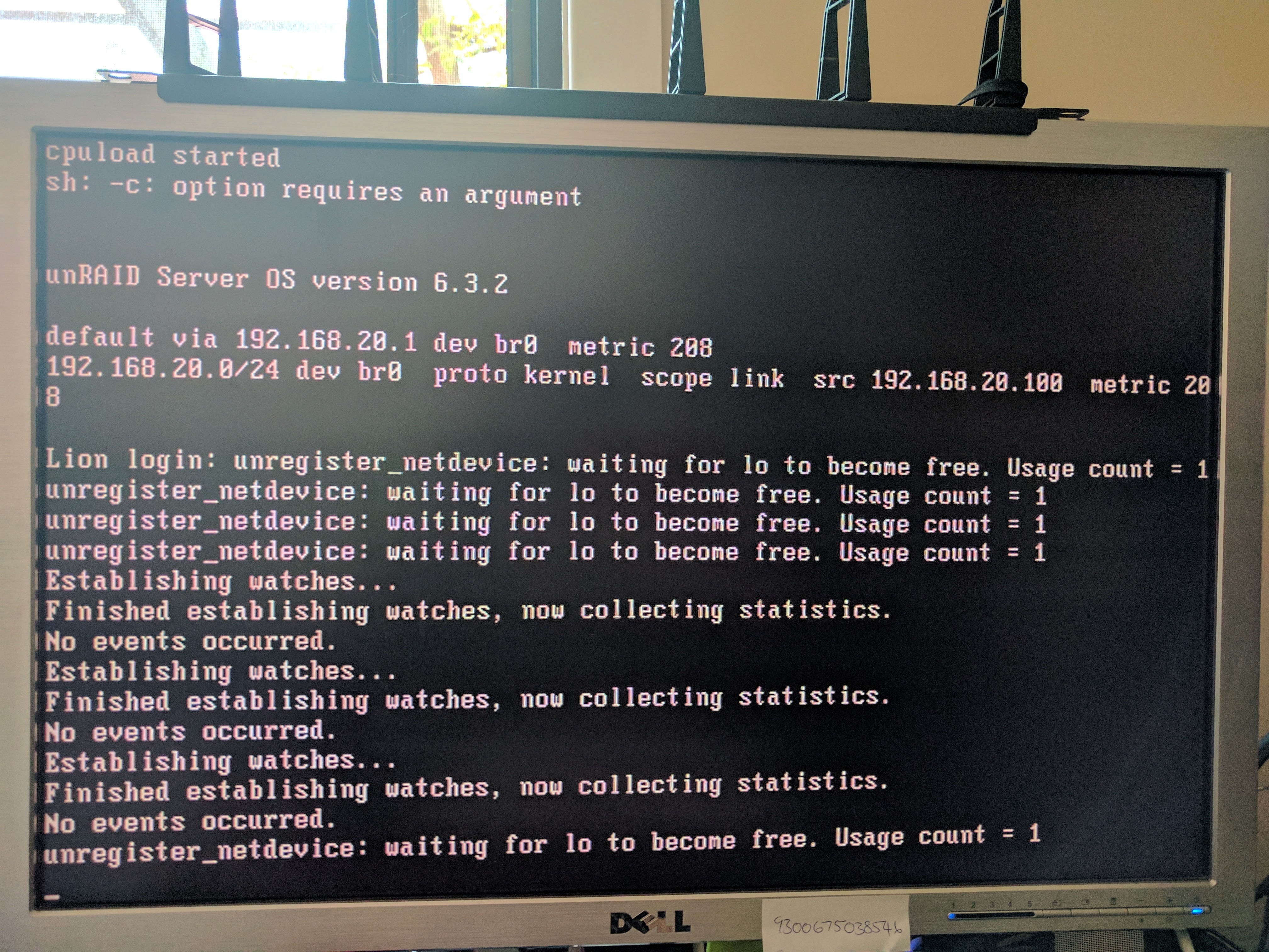

Mine doesn't exactly seem like it was straight after an update. I have done each update through the plugin tab within a few days of it being released. I just seem to have same symptoms as you. I did notice on the local console after a lock up that I had the unregistered net device line and waiting for lo to become free. I don't know what this means but could it be related?
Sent from my SM-G930F using Tapatalk
I also have that on the console line as well so let's see what others say
Unregister net device blah blah is a common and harmless measage
Sent from my LG-D852 using Tapatalk
Good to know, thanks.
