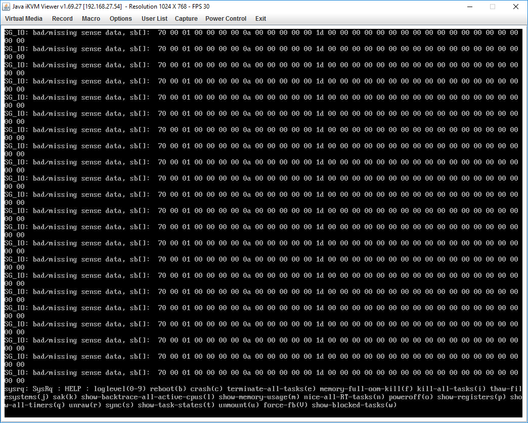

Server just failed again.
Base unRaid and plugins only, with CIFS and NFS access. Diagnostics from this morning are 2 posts above. The server works fine for a few hours. Then appears to run out of memory. This only happens since I upgraded to 6.3.2
All CIFS and NFS access has stalled.
The console is responsive at the login prompt, but if I press root [enter] the cursor just sits there, with no further messages. I can return to the login prompt by pressing ctrl-c
There is a sysrq help message - see screenshot.
