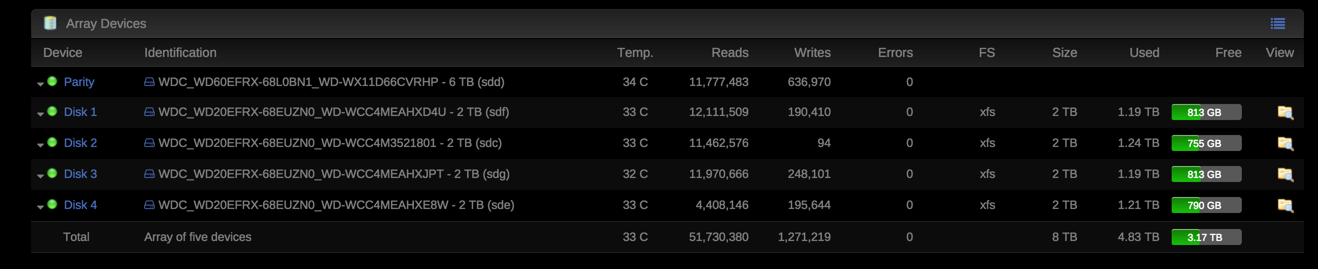

So I stopped my dockers to see if that was the problem and no dice.  I have attached a screenshot of my main page.  Look at the writes on disk 2.  I think there is something fishy going on.  However I do not have any SMART errors.  I have also attached my full diagnostics.

I did have 1 last question.  Per my screenshot above....why would disk 2 have such a low number of writes?  Is that something to be concerned about?
Read / write counts aren't 100% reliable, since it depends upon drivers, etc.  IE: You can clear the stats, do a parity check, and the drives may have wildly differing number of reads.
But, it also could indicate that nothing is being written to the drive...  You're doing a check not a rebuild...
