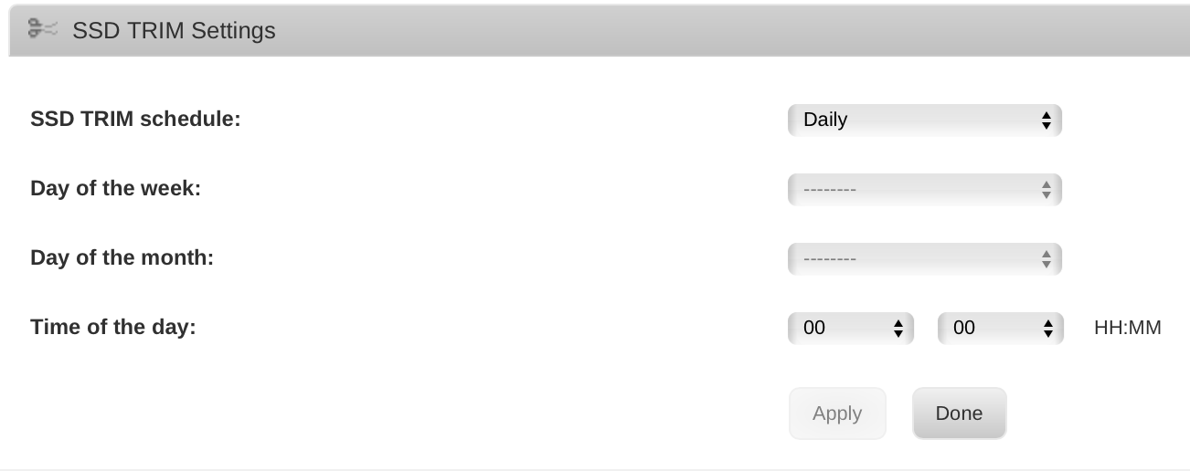

Settings -> Scheduler

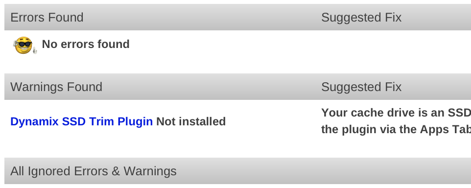

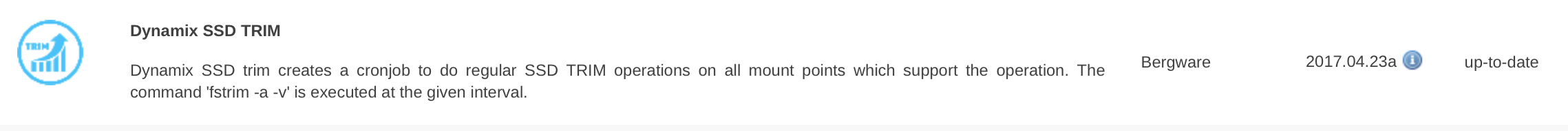

I dont understand why  i get error message that SSD-trim isn't installed and activated when it is???

Did you originally get the warning and then install and the warning is still there? Hit rescan if that's the case
Sent from my LG-D852 using Tapatalk
A rescan didn't help. But afterwards i rebooted my server it worked ?
