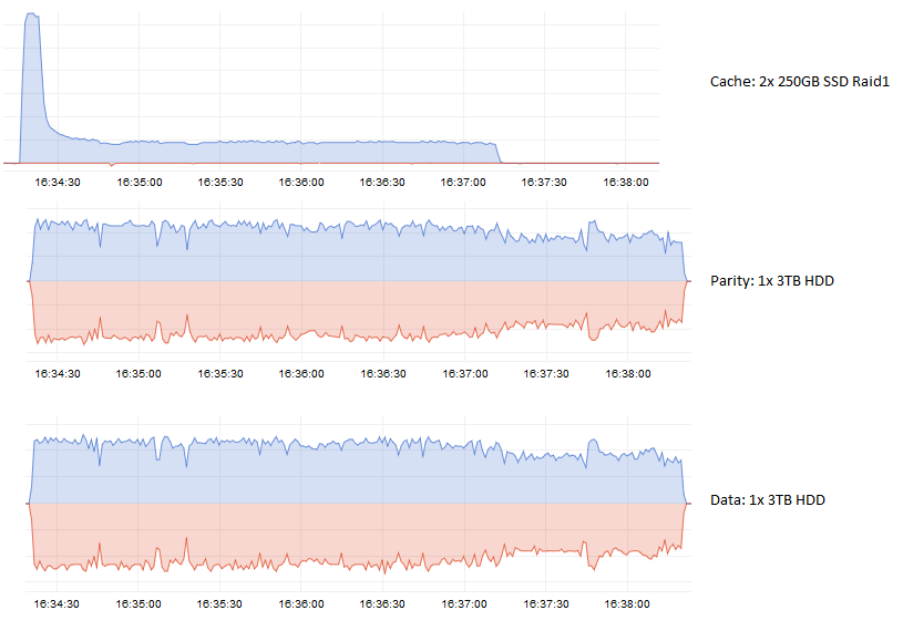

I had the similar experience just now...
I copied about 200GB to a share with cache enabled (set to Yes) and when i manually invoked the mover it seems like the copy and the parity are running at the same time because both the data disk and the parity disk reads and writes simultaneously.
I though that unRAID would fist move the data from the cache drive to the data disk then run the parity check. Or does it do both at the same time?
Is this normal?

Parity in unRAID is always updated in real-time.
Okey so this is why it's reading and writing at the same time. This is kinda bad for performance, hence that's why we use cache drives i guess.
Is there a way to pause the parity check or temporary disable it?
Not temporarily, there is a faster writing mode called reconstruct write, aka turbo write, at the expense of all disks spinning up for writes, see below for how each mode works:
