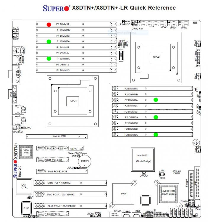

I think I have an approach.
The following command gives this output.  It shows I have 5 x 8GB sticks installed.  But I know I have 6x 8gb sticks installed.  The Locator field tells me the name of the DIMM Slot.  So it looks like P1 DIMM 3A is either a bad slot or had a bad stick.  Did I interpret this properly?
I have attached a diagram of the motherboard.

Ok.  I replaced P1 DIMM 3A with a spare 8 GB stick and it seems to be running fine and reporting 48 GB of Ram.  Thanks again GC.
Slap face with palm -- hadn't even thought of using dmidecode ... and yes, I was aware of it.   I was thinking "what would identify an individual memory module" ... but all you needed was "which slots have memory installed in them" -- since the defective module clearly wasn't being recognized :D
