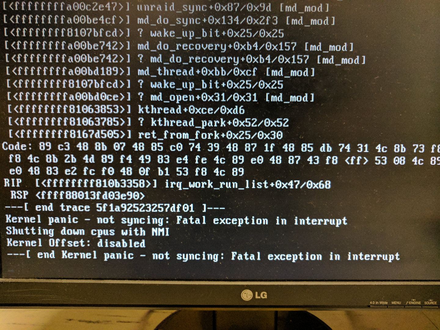

The system had locked up yesterday so I was forced to shut it down uncleanly. I brought the system back online, disabled the smb shares and docker (to disable unnecessary network access) and let a parity check run overnight. However, the system crashed some time during the night, during I suspect the parity check. The terminal output from the crash is below. I was unable to pull diagnostics at this moment since the server was unresponsive.

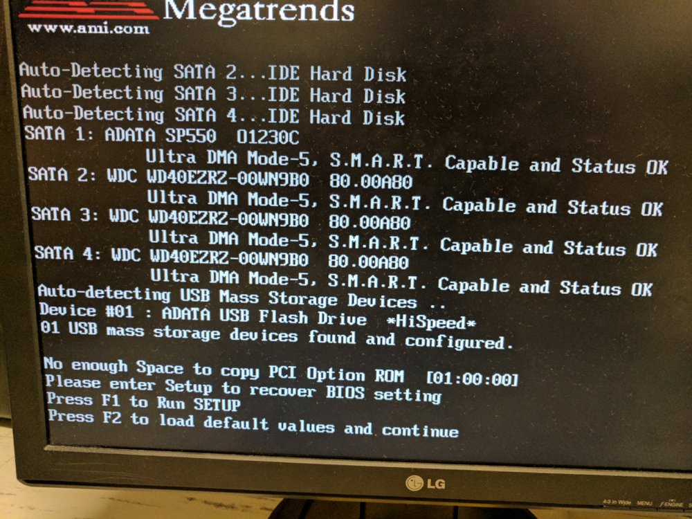

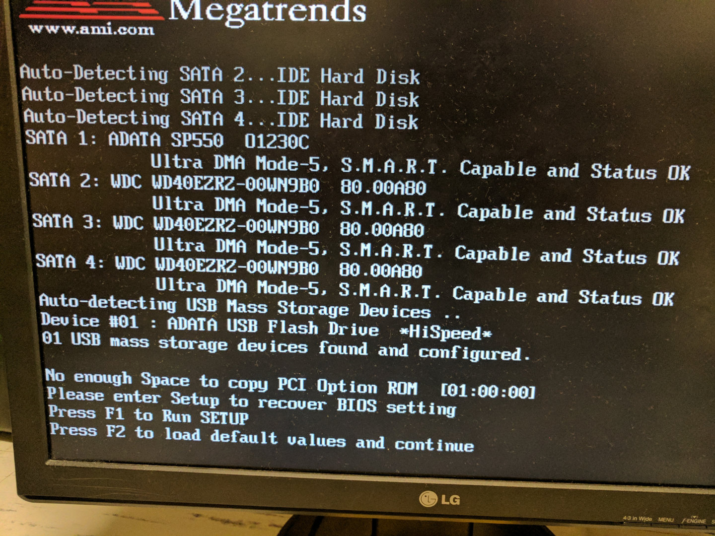

After the crash I turned off the box and turned it back on. Fans turned but no video, no LAN activity, nothing. Tried again, same result. I then powered off, unplugged everything, plugged it back in and it turned on. Bios stopped on the message below.
I had to reset the BIOS to default settings, then set the BIOS to boot from the unraid USB, and finally it booted into unraid. Everything seemed normal in unraid at this point. All drives were showing available with no errors. Attached is a diagnostics zip file taken from the first successful reboot. fmrlserv-diagnostics-20170307-1208.zip To me it appeared that the server booted normally here, however the syslog does contain a new error I've never seen before:

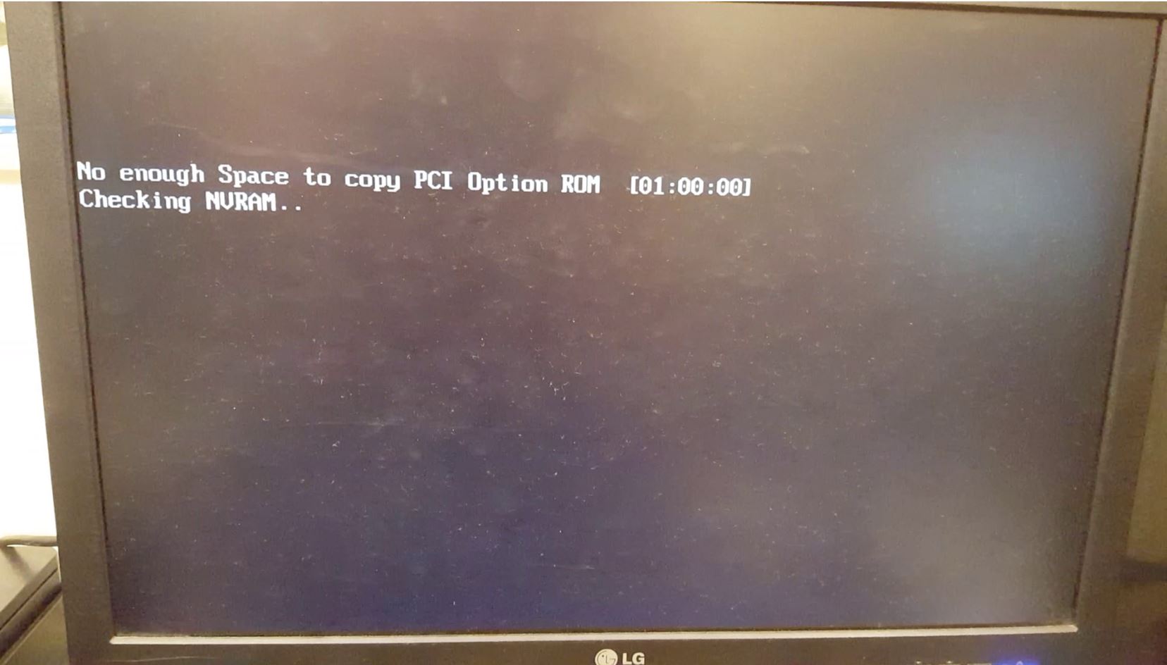

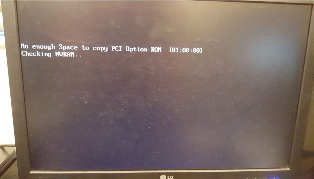

One other strange observation about the reboot process. Since the crash I've since rebooted the system a few times, and each time I am noticing a message regarding NVRAM (from the BIOS?) that I do not believe I have seen before. See the image below. I am not 100% sure on this since the message flashes very quickly (had to take a video in order to capture the still), but I am fairly certain the message is new.
