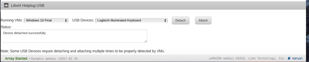

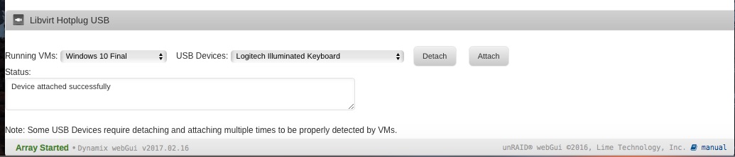

Thank you very much for this excellent plugin .. I installed and works well with other USB, but the keyboard does not work! :( Let me explain: it works, I attach a screenshot to make you understand that it is properly mounted and turn it on key lights! But Windows does not receive input from the keyboard.
It will be a driver problem ??
The Reason That It could be the only keyboard of a unRaid system? The system would then 2 keyboards?
1) for a normal raid
2) for vms ..
Unfortunately at the moment I have no other home keyboards to try ..
That's odd. I feel the basic functionality of the keyboard should just work, but if you haven't installed the setpoint software inside the VM, you might want to try that.
