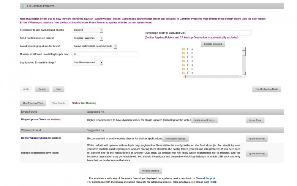

I downloaded the Fix Common Problems app and it finds only that the automatic update is turned off (turned off by me) and that a second registration key is found - i've fixed this instantly

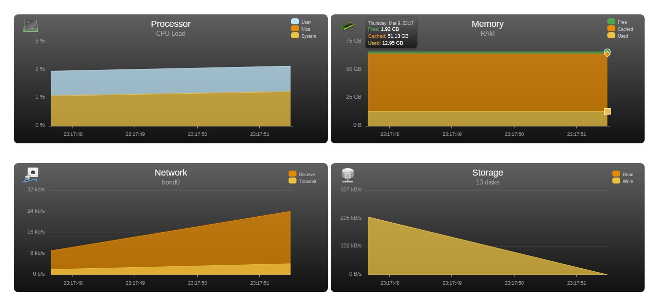

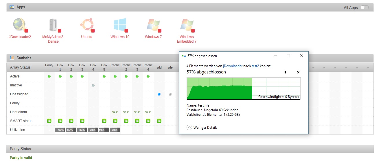

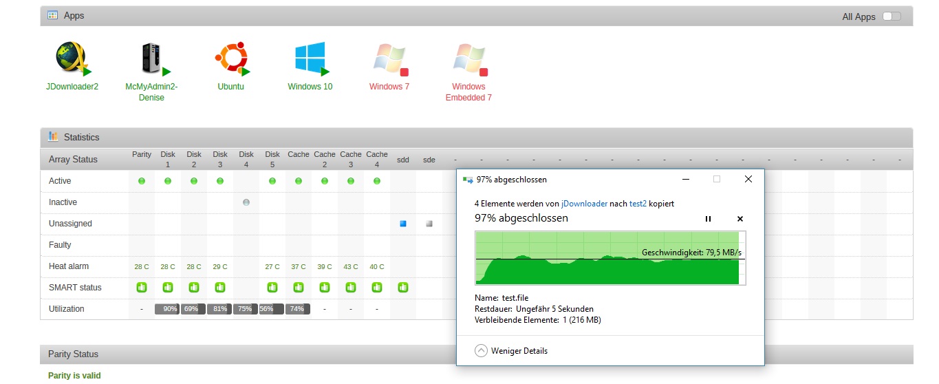

Then i started my testing (testfile is a 8,5GB img file), i turned everything off Docker, VM - still same behavior
copyspeed.thumb.jpg.91ae328775399a00a417d972f9157e5c.jpgsystem.thumb.jpg.b4eb8e592fde72b20325d715dfde4fc1.jpg

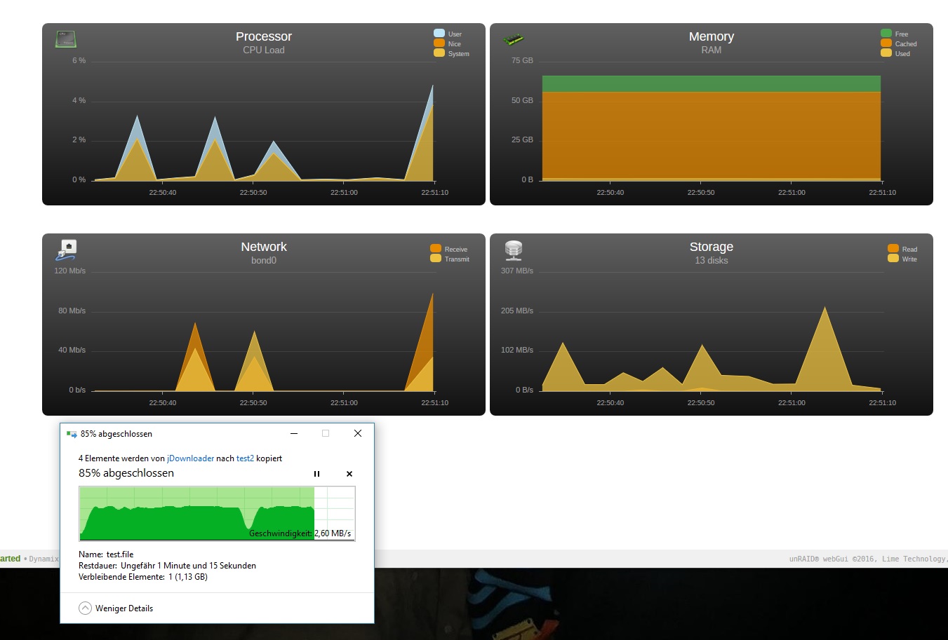

Then with dockers on - copy speed is ok but everything else is not responding, dockers and webgui
Then with everything on (copy speed is ok everything responds great but at the last 300MB the speed goes down to 15MB/s after 10 seconds it goes up to 105MB/s it finishes and nothing is responding for about 1 minute)
I think it has something to do with the Memory
If all my dockers and two VM's are turned on the Memory is allmost full and the copyspeed is like i described in the first post (I know that Linux holds a lot in the cache but is this right?)
I dont understand why nothing responds for about a minute, can copy from system memory to the SSD's make the system this much unresponsive?

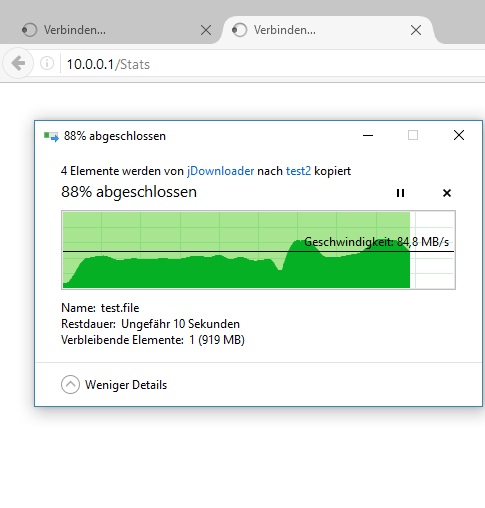

Strange is if go to my VM through the RDP connection and began the file transfer (file was 20gb because of the much faster copy speed) i experienced the same as described above copy speed went down to 0kb/s, Unraid is unresponsive, VM doesn't respond, docker doesn't work after ~30secs the copy continues the vm and everything else respons normaly after a few seconds the copy speed drops again and everything is, again, unresponsive.

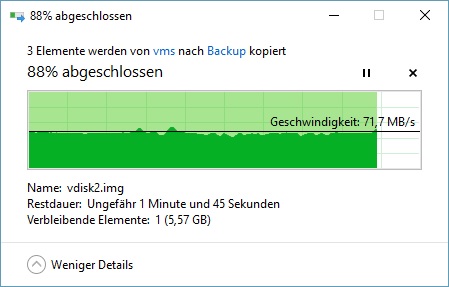

i've copied a VM image to another share (on the Cache Disk), same problem as discribed above and i discovered this in the log:
Mar 18 20:23:24 chipsServer kernel: perf: interrupt took too long (2591 > 2500), lowering kernel.perf_event_max_sample_rate to 77000
Mar 18 20:23:47 chipsServer kernel: perf: interrupt took too long (3322 > 3238), lowering kernel.perf_event_max_sample_rate to 60000
What means this? Is this part of my problem?
Edit:
Another strange thing that i discovered is when i copy files from my Cache Pool to my Unnassigned Drives the copy speed is constant, something must be wrong with the cache disks...
Edited by ich777
Attached screenshot
