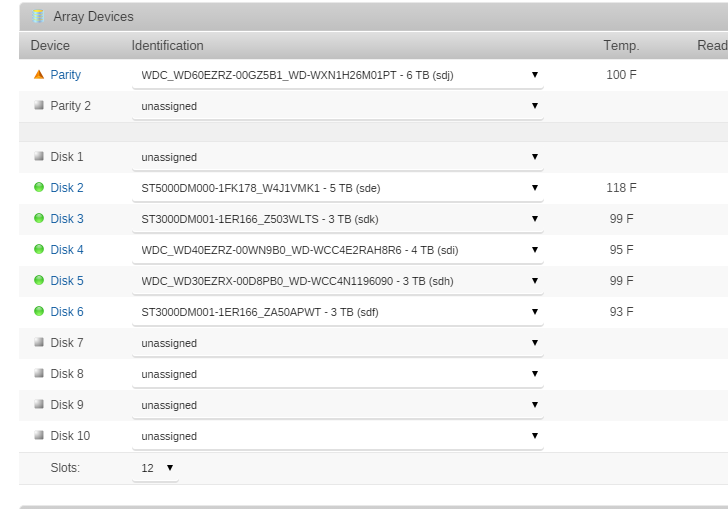

Why don't you have a disk assigned to slot 1?
trurl
I tried to assign one but the disk I assign said It could not. LIke the 5 others that I can not add.
The original reason for the post. I can not assign certain disk. 1-WD disk,  4-hitachi disk.
The WD disk was assigned to be disk 1. but I had to un-assign it to get the array to start.

Sounds like maybe you had another disk assigned to slot1 and then you tried to assign a different disk there. Probably the way out of this is to set a New Configuration and rebuild parity.

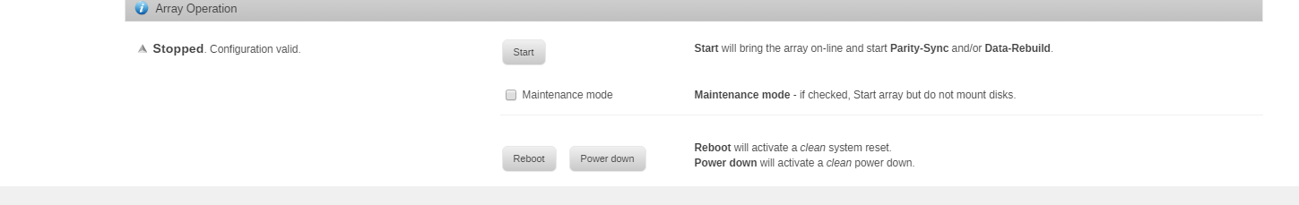

Stop the array and then post a screenshot of Main - Array Devices and another screenshot of Main - Array Operation.
You need to let the parity sync finish before adding new disks (or doing a new config), you cant add new disks while parity is not green.
Well I could not wait 27 days for the sync to finish. So I did exactly that a New config Added my disk in 5tb 4tb and 7 3tb drives and its up and running with no drives to add.
That problems is taken care of and my data is still there.
PROBLEM SOLVED.
