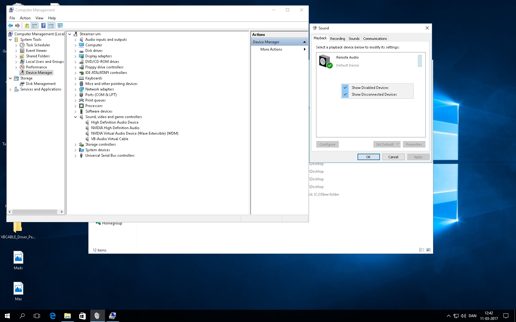

I tried both the virtual audio cable, and adding the new device to xml.
But still looks like i cant use those device when connecte with RDP.
Ahh i think i found the issue, simply me needing to change settings when connecting with RDP, to use the host audio, instead of playing on remote.. (doh!)
Thanks anyways! :)
