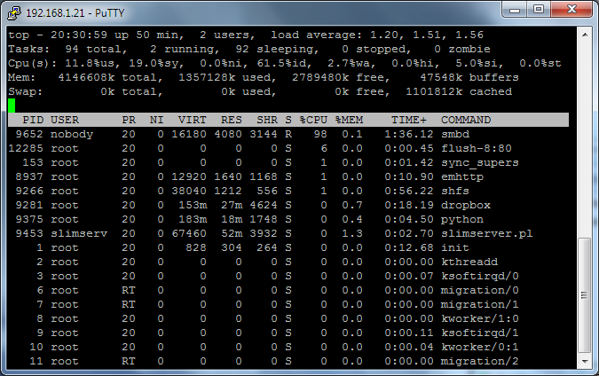

checked it with running top while copying to the ssd cache disk directly:
process smbd takes 100% cpu

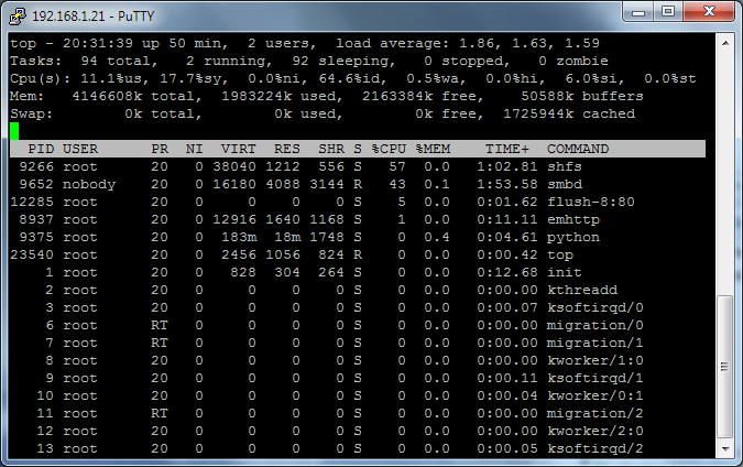

when copying to a cached user share, smbd takes 45% cpu according to top, and is the accompanied by shsf process which takes 55%.

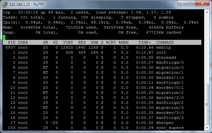

Took some screenshots.
First one, system is 'idle'.
2nd one, copying a file to the ssd (cache disk) directly
3rd one, copying to a cached user share

From your previous screens it appears your cpu is your bottleneck. When writing to cache directly smbd can use the entire CPU, netting you higher speeds. When copied to user share, shfs kicks in, stealing some CPU cycles and slowing things down.
One would say an 1.8GHz Atom CPU would be sufficient to handle some basic file copying?
Not entirely. It's quite a slow cpu, also some chipsets for the atom have slower disk performance than the Intel i3/i5/i7 lines. :(
Mmm...  I've been lurking a lot on the forum and read great things about this board in combination wit unRAID, and now it turns out it's basically too slow for what i want, or my expectations were too high i suppose... either way, maybe i should go the Intel i3 route after all, with a nice X9SCM-F board...
It's no longer basic file copying when copying to a user share, that's why its becoming a bottleneck.
Writing directly to cache shfs isn't used, so it uses no cpu. Writing to the user share, it is writing to the same location but now shfs is looking at the data, where its destination is, the settings for that share(cache or not, split level, fill settings, amount free on disks in that share) to figure out where its going to end up. This spike in processing eats up valuable cycles, something that probably would never be noticeable but since your using a fast SSD, you've moved the writing bottleneck from the drive to the cpu.
