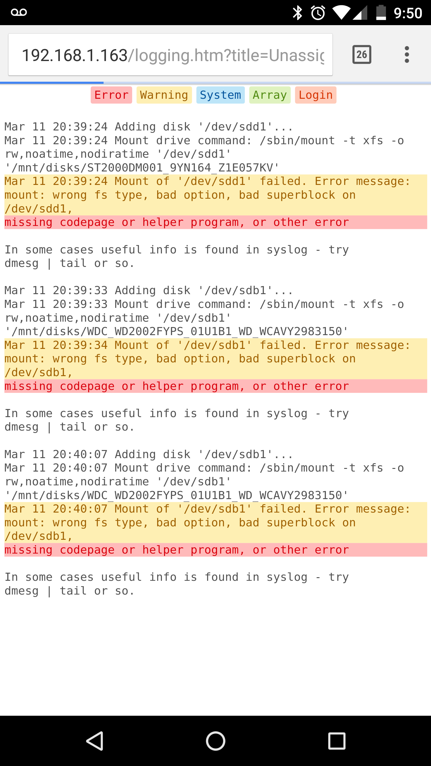

These were my results when trying to mount it with unassigned disks after.
Feb 26 13:47:28 Mount of '/dev/sdq1' failed. Error message: mount: wrong fs type, bad option, bad superblock on /dev/sdq1,
